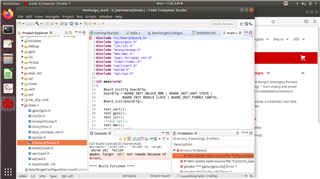

I want to run  ARM and DSP in AM5718
IN ARM I RUN AND DEBUG
WHEN I BUILD DSP PROCESSOR
**** Build of configuration Debug for project ti_baremetal ****
/home/medongo/medongo/ti/ccs930/ccs/utils/bin/gmake -k -j 4 all -O
Building file: "../main.c"
Invoking: C6000 Compiler
"/home/medongo/medongo/ti/ccs930/ccs/tools/compiler/ti-cgt-c6000_8.3.5/bin/cl6x" -mv6600 --include_path="/home/medongo/Downloads/deal_2021-master-deal-sitara/deal/sitara/cc66/bm" --include_path="/home/medongo/medongo/ti/ccs930/ccs/tools/compiler/ti-cgt-c6000_8.3.5/include" --include_path="/home/medongo/ti/sdkrtos/pdk_am57xx_1_0_17/packages/" --include_path="/home/medongo/ti/sdkrtos/pdk_am57xx_1_0_17/packages/ti/csl/src/ip/gpio/V1" --define=__TI_NO_PARALLEL_LOADS=1 --define=DEVICE_AM571x -g --diag_warning=225 --diag_wrap=off --display_error_number --preproc_with_compile --preproc_dependency="main.d_raw"  "../main.c"
>> Compilation failure
subdir_rules.mk:7: recipe for target 'main.obj' failed
"../main.c", line 1: fatal error #1965: cannot open source file "ti/board/board.h"
1 catastrophic error detected in the compilation of "../main.c".
Compilation terminated.
gmake: *** [main.obj] Error 1

ERROR IN
Description Resource Path Location Type
#1965 cannot open source file "ti/board/board.h" main.c /ti_baremetal line 1 C/C++ Problem
#1965 cannot open source file "ti/csl/csl_qspi.h" qspi_cmd_init.h /ti_baremetal/qspi_nor line 44 C/C++ Problem
gmake: *** [gpio/gpio.obj] Error 1 ti_baremetal C/C++ Problem
gmake: *** [i2c/i2c.obj] Error 1 ti_baremetal C/C++ Problem
gmake: *** [main.obj] Error 1 ti_baremetal C/C++ Problem
gmake: *** [mcasp/mcasp.obj] Error 1 ti_baremetal C/C++ Problem
gmake: *** [mmc/mmc.obj] Error 1 ti_baremetal C/C++ Problem
gmake: *** [qspi_nor/qspi_cmd_init.obj] Error 1 ti_baremetal C/C++ Problem
gmake: *** [qspi_nor/qspi_flash.obj] Error 1 ti_baremetal C/C++ Problem
gmake: *** [qspi_nor/qspi_nor.obj] Error 1 ti_baremetal C/C++ Problem
gmake: *** [spi/spi.obj] Error 1 ti_baremetal C/C++ Problem
gmake: *** [timer/timer.obj] Error 1 ti_baremetal C/C++ Problem
gmake: *** [uart/uart.obj] Error 1 ti_baremetal C/C++ Problem
gmake: *** [uart/uartConfig.obj] Error 1 ti_baremetal C/C++ Problem
gmake: *** [wd/wd.obj] Error 1 ti_baremetal C/C++ Problem
gmake: Target 'all' not remade because of errors. ti_baremetal C/C++ Problem
Invalid project path: Include path not found (/home/medongo/ti/sdkrtaos/pdk_am57xx_1_0_17/packages/). ti_baremetal pathentry Path Entry Problem
Invalid project path: Include path not found (/home/medongo/ti/sdkrtos/pdk_am57xx_1_0_17/packages/ti/csl/src/ip/gpio/V1). ti_baremetal pathentry Path Entry Problem
This project was created using a version of compiler that is not currently installed - 8.3.8 [C6000]. Another version of the compiler will be used during build - 8.3.5. See 'Help > Install New Software' and select 'Code Generation Tools Updates' to check if this compiler is available through a CCS update. Visit <a href="liveaction:OpenAppCenter">CCS App Center</a> to get the latest compiler support. Or <a href="">software-dl.ti.com/.../a> and install the compiler, then register it with CCS through 'Preferences > CCS > Build > Compilers'. ti_baremetal properties Problem
This project was created with a newer version of Code Composer Studio - v10.3.0. It is recommended that you upgrade to v10.3.0, or newer version of Code Composer Studio, to ensure optimal compatibility. ti_baremetal project Problem
Kindly help to build and debug in arm and dsp processor
regards ,
venkat.s
