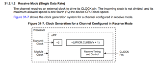

Which of the following is true?
1. Found in https://www.ti.com/lit/ds/symlink/sm320c6748-hirel.pdf?ts=1645654035840&ref_url=https%253A%252F%252Fwww.ti.com%252Fproduct%252FSM320C6748-HIREL pg203/265
2. Found in TMS320C6748 DSP Technical Reference Manual (Rev. A) pg1469/1752
Also, what happens if we drive uPP clock with 100MHz SDR?
