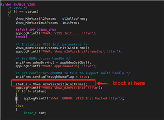

I found sometimes mcu2_0 gets stuck at Vhwa_m2mVissInit, which causes the other inits, such as appIssInit after the viss is not initialized properly. Currently, I have no idea what caused this issue, wish TI could offer some help here. Attach the log below. BTW, After optimizing the kernel by modifying loglevel to 0 in linux SDK, this problem occurs more frequently, does it related to timing? how should I do? we are using A72(linux)+R5F(rtos), SDK 8.0, thanks !
#1. Where the MCU2_0 get stucked:
#2. The full log of R5F cores, stuck at Line 31640

2021-08-04_22:20:51.31640 [MCU2_0]    222.365574 s: VHWA: VISS Init ... !!!
2021-08-04_22:20:51.31643 [MCU2_0]    222.365598 s: VHWA: Vhwa_m2mVissInitParamsInit !!!
2021-08-04_22:20:51.31643 [MCU2_0]    222.365621 s: VHWA: appUdmaGetObj !!!

#3. The log of app in A72 linux, which can't Enumerating sensor successfully since the appIssInit at MCU2_0 is not initilized properly, MCU2_0 gets stucked at previous Vhwa_m2mVissInit

    Could you please clarify my below queries regarding this issue,
    1. Are you observing the hang at the same place i.e.Vhwa_m2mVissInit everytime?
    2. Could you try setting the variable "initPrms.configThroughUdmaFlag" to false and check if the issue can be reproduced?
    3. Have you tried going deeper into the function Vhwa_m2mVissInit() to know the exact point of hang?
    Nikhil
  • Hi Nikhil,
    1.yes, everytime hangs at he same place.
    2.What is the purpose of this flag? If I change it to false, will it have any potential unpredictable impact to vision app? Actually, this problem no longer occurs after moving ETHFW_Init to the end of app_init, but I have no idea why, just assuming it may related to some timing. This uncertainty makes me wonder whether this problem will appear again at some time.
    3.Not yet, like I mentioned above, this issue seems disappear after changing the sequence of the init, I'm very confused about it. I could do a further investigation if necessary, but it not always occurs.
    thanks
    Ethernet firmware has no dependency on VISS, so I doubt if that was the issue.
    The purpose of setting the flag to false and testing was to check if the issue is with the Configuration of VISS through UDMA. It would be great if you could test this scenario.
    Also could you do a clean build once as shown below in order to ensure that this is not a build issue?
    cd vision_apps
    make sdk_scrub
    make sdk -jN    .......... with "N" being the number of parallel threads
    Also are there any changes in the SDK?
    Nikhil
