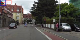

TDA4VM: Converting a yolov3 or yolov5s model to a bin file seems to show poor results.
Part Number: TDA4VM
This is the result.
Below is my steps to use tidl_model_import.out to get the bin file:

step4 successfully convert the onnx and prototxt to the bin file but the test image has a really bad result.
Could you help me with this problem?
