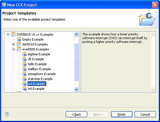

Start by reading the documentation on using Code Composer Studio. Make sure you have one of the more recent versions of CCS and DSP/BIOS.
File->New CCS Project
Create the project for a project type (C5500) and device that supports DSP/BIOS.
Follow the wizard to create a DSP/BIOS project from one of the examples. The wizard may look like that below. I suggest trying more than one type of project if you are using DSP/BIOS for the first time.
