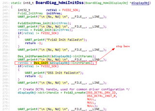

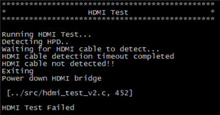

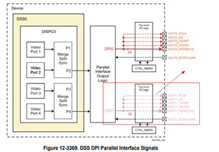

Is this demo depended on HW? My board use DPI1 connect to hdmi screen. I see the source code is DPI0, so i modify DPI0 to DPI1, then compile it.
i find that it test fail. the log is below.

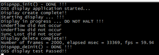

In fact, the hdmi cable is connect to my board all the time. then i delete hdmi cable detection code, and recompile again.
i test this demo app, it  also fail, this is new log as below. it  stop in Dss_init  function.
