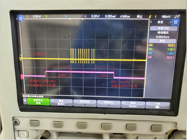

Hello Champs,
HW: customer own board
SW: processor_sdk_rtos_am57xx_06_03_02_08
Customer's code is based on MCSPI_BasicExample_Dma_idkAM571x_c66TestProject. He connected the SPI1D0 to SPI1D1 for external loop mode.
1. SPI could run in interrupt or polling mode with 48MHz.
2. SPI+EDMA can't work, all the registers' configuration are correct, it should trigger the edma with the MCSPI_CHxSTAT value is 0x28, but the edma is not triggerred.
3. Modify
SPI_dma.c trigger event to manual trigger, emda can work but the data is wrong.

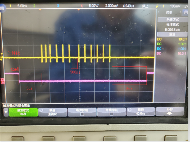

4. After running MCSPI_transfer, the oscilloscope shows no data being transferred, after 10-20us, it began to transfer, CS is pulled high after 5-10us when completing transfer,there is 200ns-500ns latency between bytes,that is, it took about 30-50us to transfer 10bytes data.
5. Despite the data is allocated on L2SRAM or DDR3, the issue is the same.
The problems are
1. Why SPI+EDMA can't be triggerred?
2. Why there is so large latency?
Below are the configuration code and timing wave.
