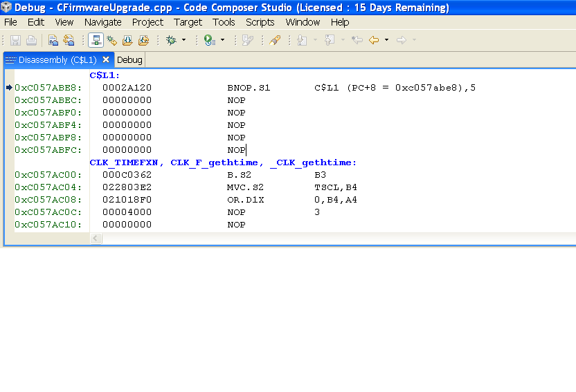

I am working TMS320C6748 Processor.
I am facing dynamic memory allocation problem.Whenever i do new ,the processor hangs.Huge Heap memory is allocated through .tcf file.All the section are assigned in external memory.
I am using DSP/BIOS and SWI's(2 Software interrupts).
The code runs smoothly when SWI's are not used.Pls somebody help me on this

  • Can you clarify what you mean by "hangs"?   Can you look in disassembly window and find the program counter?  What function is it in?   BTW, all memory allocation is not allowed from SWI context.   This is because the memory allocator uses a blocking lock to make it thread safe.  You need to do all memory allocations from main() or from a task.
    -Karl-

    i went through the disassembly window.The programme counter is pointing at C$L1: It is not coming out of this even setpin is done.
    I am attaching the disassembly file.Pls help me in solving this.

    I am not doing new within SWI.I am not assigning any pointer to a local variable SWI.I am just calling a function in a SWI that in turn creates a dynamic memory(new).
    Pls let me know if i am wrong.Also pls help me in solving this.

  • You say "I am just calling a function in a SWI that in turn creates a dynamic memory".   This means that you _are_ calling memory allocation from a SWI.  This is not allowed.
    Can you review your disassembly view and see what symbols are above that C$1 (or whatever).   There should be an external symbol above that that gives us a clue.   You should also look in ROV (tools->ROV) and look in the LOG view to see if you see a useful error message.
