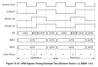

Regarding the MPC885 UPM, I would like to verify my understanding, that for every CLKOUT cycle, four 32bit RAM words are sampled to the processor relevant outputs, as shown below from the Reference Manual:
