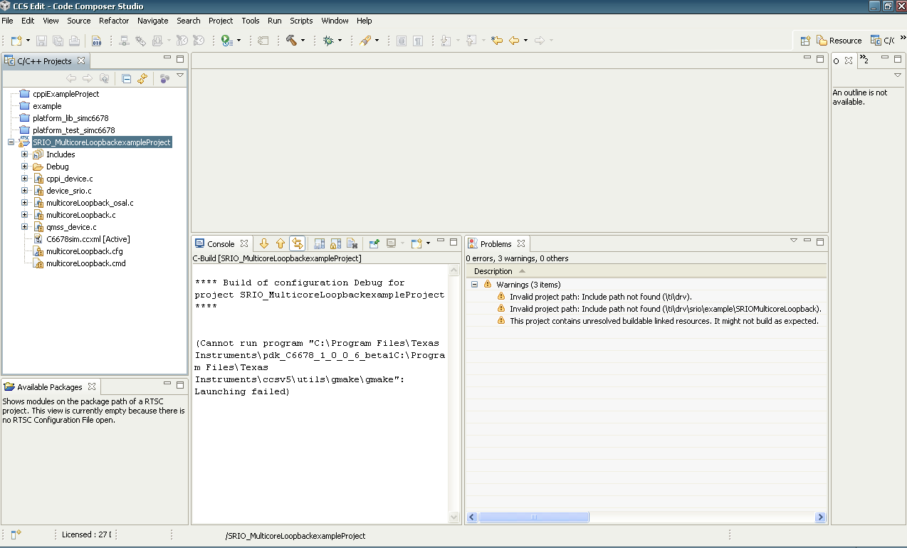

    but after i made  build project the warnings appears ...see  image below
    please for compile flag SIMULATOR_SUPPORT
    how can i define this for CCS project ?
    is this procedure correct ?

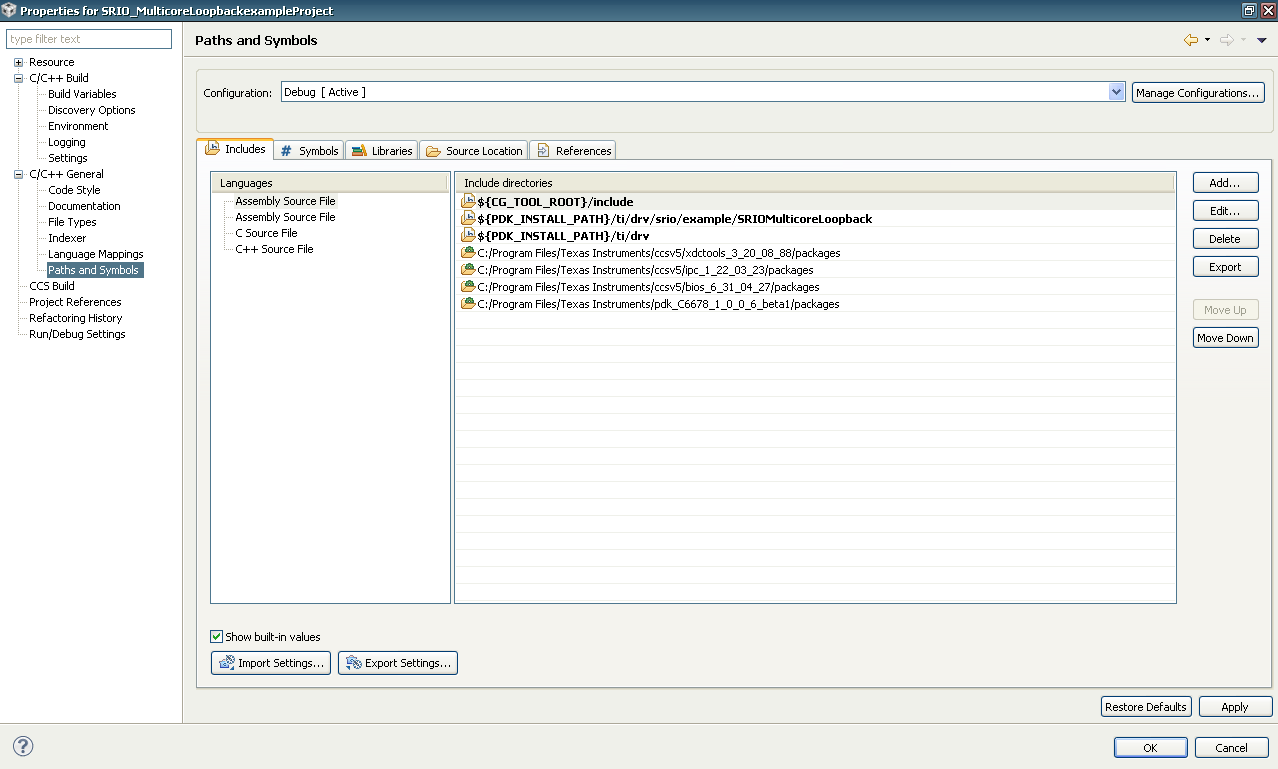

    From the screen shot it appears like the macros.ini is not imported,
    Please refer to http://processors.wiki.ti.com/index.php/BIOS_MCSDK_2.0_User_Guide#Building_the_Device_Drivers_Example_Projects for importing the macros.ini for the project.

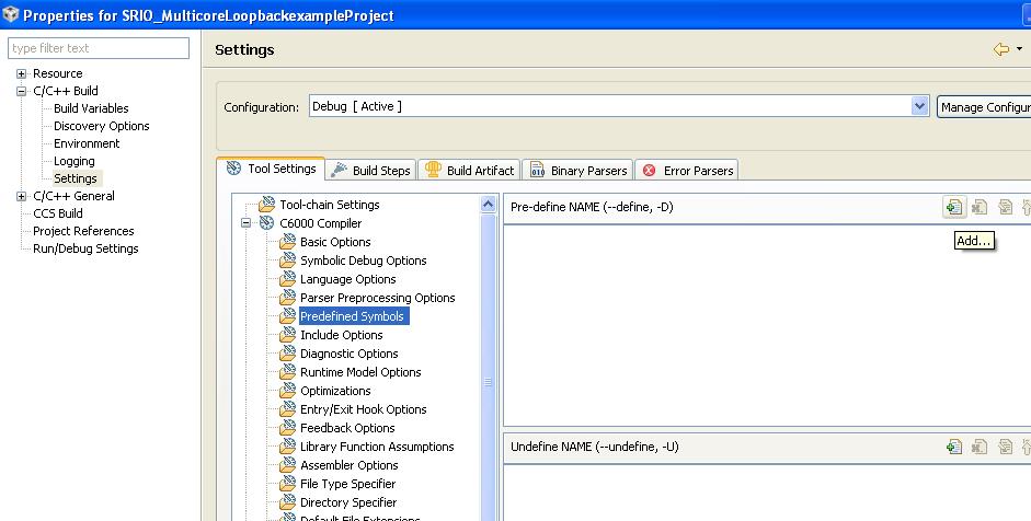

    Regarding setting the compile time defines in CCS,
    Goto the below window using CCS and Click on Add to add the symbol "SIMULATOR_SUPPORT" and recompile the project. Let me know if it helps.

    1-Import macros.ini located under \pdk_C667#_1_0_0_6_beta1\packages\ti\drv.
    2- I added the  'SIMULATOR_SUPPORT'  in Predifined symbols....
    After 'Building' project all the Warnings are disappeared.
    but in the console  the message appear :
    (Cannot run program "C:\Program Files\Texas Instruments\pdk_C6678_1_0_0_6_beta1C:\Program Files\Texas Instruments\ccsv5\utils\gmake\gmake": Launching failed)

    Good to know that you could build the project.
    I assume you are able to build the .out file with the changes.
    Not sure about this message - looks weird
    (Cannot run program "C:\Program Files\Texas Instruments\pdk_C6678_1_0_0_6_beta1C:\Program Files\Texas Instruments\ccsv5\utils\gmake\gmake": Launching failed) .
    Can you delete the Debug (and Release) directories that got created by CCS and try to rebuild the project?
