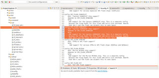

I wanna use S28HL01GT  in my custom board.
But In the linux SDK (uboot and kernel) the S28HL01GT  is not included, i only see S28HS512T .

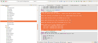

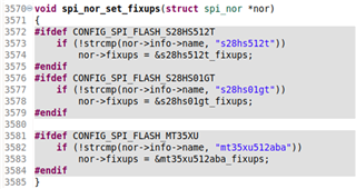

So I modified some codes for S28HL01GT (based on code for S28HS512T ) as below:

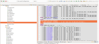

  • Add Infos for S28HS01GT in spi-nor-ids.c

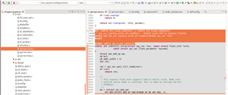

  • Define spi_nor_cypress_octal_dtr_enable(struct spi_nor *nor) in spi-nor-core.c
  • Add S28HS01GT apis in spi-nor-core.c by doubling the apis for S28HS512T the changing their names
  • Add S28HS01GT code in spi-nor-core.c

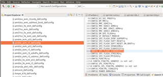

  • Define S28HS01GT in defconfig file
  • Add S28HS01GT config in Kconfig files
In kernel I also add similar information in spansion.c file
I did not change anything in ospi config.
It does not work.
Can you give me the guide, drivers and ospi configuration(if needed)to use S28HS01GT in my custom board.
