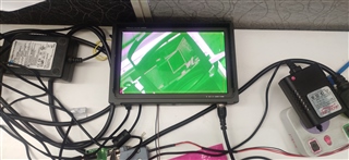

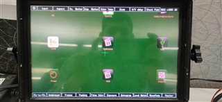

Hi sir,
I am using AM5728 custom board (AM5728->GS2962->LCD lilliput device)
Actually AM5728 board connected to gs2962 serializer to external lcd monitor.
Power on green display occurs.
Using below commands i am sendind video from one board to another board.
BEAGLEBOARD-X15
sudo ifconfig eth0 192.168.31.173 netmask 255.255.254.0 up
HOST=192.168.31.175
gst-launch-1.0 -e v4l2src device=/dev/video1 num-buffers=4000  ! 'video/x-raw, width=1920, height=1080, framerate=30/1, format=YUY2' ! vpe num-input-buffers=8 ! queue ! ducatih264enc intra-interval=1 ! h264parse ! rtph264pay ! udpsink port=5000 host=$HOST
CUSTOM-BOARD
sudo ifconfig eth0 192.168.31.175 netmask 255.255.254.0 up
gst-launch-1.0 -v udpsrc port=5000 ! "application/x-rtp, media=(string)video, clock-rate=(int)90000, encoding-name=(string)H264, payload=(int)96" ! rtph264depay ! h264parse ! decodebin ! videoconvert ! kmssink
Below image it's displaying:
But Using below command i am displaying and storing video into sd card.
gst-launch-1.0 -v udpsrc port=5000 ! "application/x-rtp, media=(string)video, clock-rate=(int)90000, encoding-name=(string)H264, payload=(int)96" \
! rtph264depay ! h264parse \
! tee name=t \
t. ! queue ! mp4mux ! filesink location=xyz.mp4 -e \
t. ! queue leaky=1 ! decodebin ! videoconvert ! autovideosink sync=false
In SD card storing proper image but output of lcd screen is green
storing image in sd card:
it means in gs2962 driver i want change the format from YUV422UYVY to YUV422YUYV?

Could you give me some suggestions where to change pattern type any linking about vip,vpe files in lcd?
Thanking you,
Ram,
  • Hi sir,
    Power on time only we are getting green color background with gui interface also green occurs,
    Anything we want change in OMAP_DSS_GFX, to OMAP_DSS_VIDEO1 how to change could you give me some suggestions,
    In DISPC.C we modified to GFX but one time its changing to VID1 then after it's going to GFX mode only.
    dispc.c

    Could you give me some suggestions, i am waiting for your reply,
    Thanking You,
