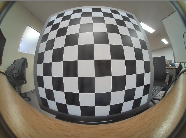

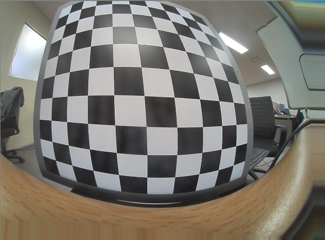

this is the input image I have captured  from camera for testing.
this is the desired output

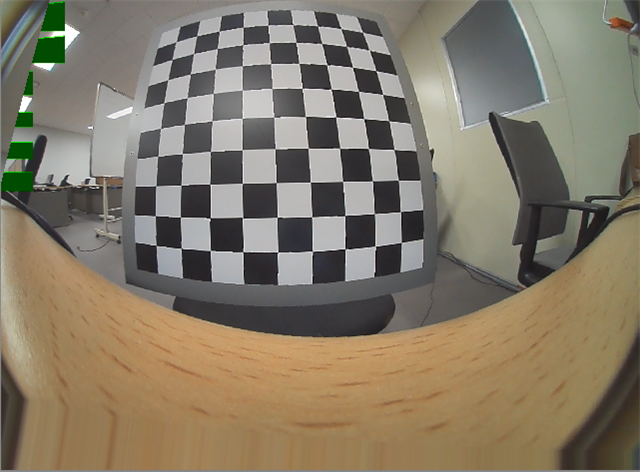

The image I am getting from (app_single_camera) for LUT I have generated
Note: I am not downsampling my LUT so I kept the downsampling factor as 1

    It looks like you might have the wrong order of x and y offsets (endianness).
    Please check the example given at the end of the FAQ: e2e.ti.com/.../faq-tda4vm-how-to-create-a-ldc-mesh-lut-for-fisheye-distortion-correction-on-tda4
    >> For example, the first row in "mesh.txt" above is "1818 (0x71a), 1341 (0x53d)", and the corresponding 32-bit binary word is "0x53d, 0x71a" in "test_mesh_lut.txt".

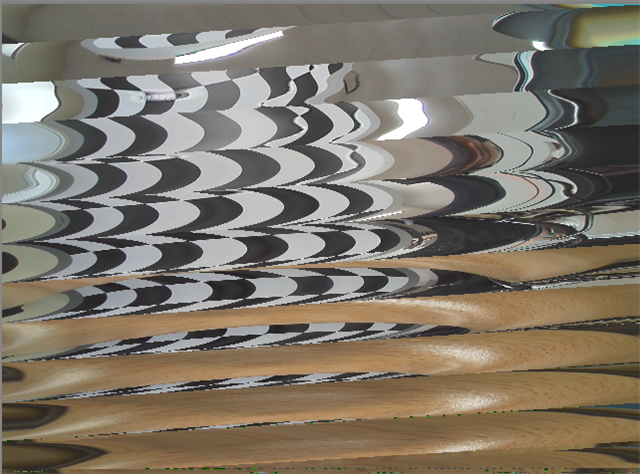

  • Hello Gang,
    I have reversed the order of coordinates like you have mentioned in the link . I am attaching the the LUT header file i have tested and the result I obtained after changing the order. Please check the LUT i have attached. Thank you
    Original Image :
    Resultant Image:
    Kind Regards,
    Myrah Naeem
    LUT with positions according to TI format
    LUT_TI_REV.h

  • Hello Gang,
    I even tried this order but the result is not correct. I am attaching the LUT header file and resultant image i have obtained
    "LUT_TI_REVERSE"
    0x43, 0x03, 0x95, 0x02, ..
    LUT_TI_REVERSE.h

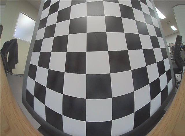

    INPUT IMAGE
    RESULTANT IMAGE
    Kind Regards,
    Myrah Naeem
  • OK, this looks like the right encoding format at least.
    You mentioned above:
    >>> "I am not downsampling my LUT so I kept the downsampling factor as 1"
    >>> "obj->mesh_params.subsample_factor = 1"
    This "subsample_factor" is m = 0, 1, 2, ..., 8 for 1x, 2x, 4x, ..., 128x down sampling.
    So, you should use 0 for no down sampling.
    Typically, you should not get valid output if you use 1 instead of 0.
    Please try 0 and let me know the result.

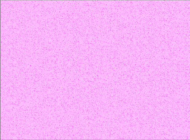

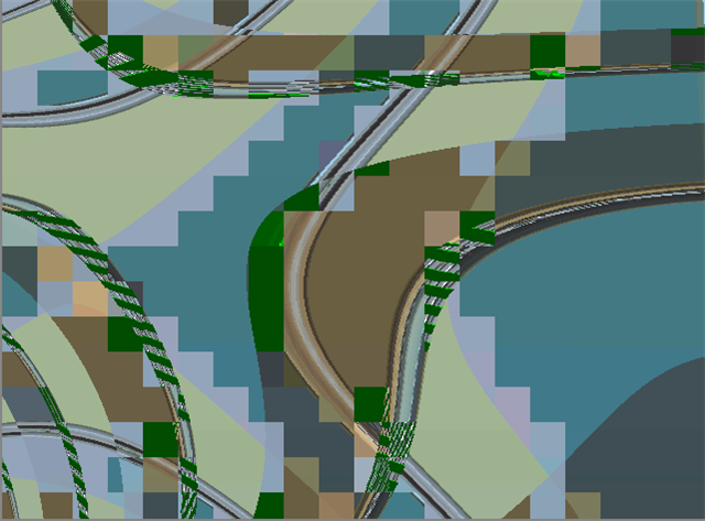

  • Thank you very much gang for helping me out.
    I kept LDC FACTOR = 0
    >>> "obj->mesh_params.subsample_factor = 0"
    The output image is attached below and the error I received at the terminal was
     VX_ZONE_ERROR :[tivxVpacLdcProcess:363] failed to submit Request
    Resultant Image :

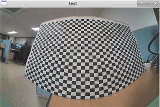

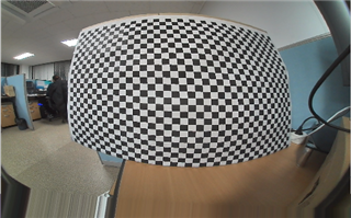

  • Hello Gang,
    I replaced top left 640x472 with my down sampled LUT with m= 1
    I am attaching LUT I have created and the resultant image i have obtained. Please check it and let me know if i have implemented the way you have suggested.
    LUT (with top-left replaced) :
    LUT_TI_top_left.h
    Resultant Image :
    Kind Regards,
    Myrah Naeem

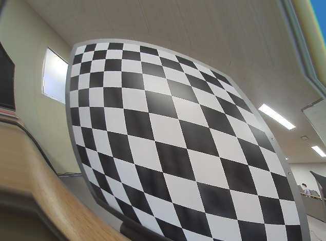

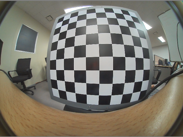

  • Hi Myrah,
    This picture above is what your output should look like given your LUT.
    Is it correct?
    In you "PCA_data.txt", you need to ensure "0 <= fix <= 1279" and "0<=fiy<=943" (you have some out of the image boundary).
    Gang
  • yes gang, my output should be exactly like the image you have posted. I will put the limits and test that LUT in single camera application. Then i will let you know the results.

    Image captured from camera :
    Resultant Image (results for both conditions are same) :
    Block Parameters :

  • Hi Myrah,
    >> "Adjacent LUT entries must be close by"
    There are issues in the left 52 columns of your previous 1280x944 LUT.
    The locations of (fix, fiy) for them jump around the image (discontinuous) from top left to bottom left to top right corners of the images in a single column.
    You need to fix out of image border issues as well as this discontinuity issue.
    This is a common problem when (fix, fiy) are generated without taking care of boundary conditions in the geometrical mapping.
    So, the first step is to get valid (fix, fiy) for all locations.
    Then, the second step is to get a valid LUT including down-sampling, integer encoding, and row alignment.
    You can follow the FAQ to get this done.
    The 3rd step is to use your LUT (tuning tool requires LUT in the matlab output format) to find the proper block parameters (LUT must be down-sampled for this to be meaningful).
    The last step is to program everything into H/W and test.

  • Hi Myrah,
    I don't have "my" LUT to share with you.
    I only used your LUT to verify if you get the geometry you want.
    Boundary clipping is OK, but you have a discontinuous mapping.
    Please take a look at the first column of your 2D 1280x944 (fix, fiy) array (944 long) and you will find the discontinuity.
    For example, the first 2 jumps (by hundreds of pixels) are between "(x=0, y=0) and (x=0, y=1)" and between "(x=0, y=844) and (x=0, y=845)".
    There are more issues like these in other columns.
    Line 1 0 0 0.000000 0.000000 0.000000 0.000000
    Line 1281
    0 1 1132.164307 78.861023 1132.164307 77.861023
    Line 1080321 0 844 260.981903 976.553711 260.981903 132.553711
    Line 1081601 0 845 1030.629150 967.051880 1030.629150 122.051880
    Once you remove all those discontinuity in your 2D LUT, you will have to choose a proper down sampling factor at m=3 or 4 and down sample your LUT so that LDC can work properly in a real application.
    Gang
  • Thank you very much Gang. This resolved my issue.
