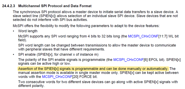

    We have to transmit data to 4 different devices.
    That is, we share the same MCSPI between 4 devices, SPI lines are shared, each device has separate CS, which is controlled by MCSPI master.
    Order is less important.
    Example:
    We would like to transmit sequence of 8, 24, 32 and 16 bytes to 4 difference devices.
    We expect that we write 8, 24,32,16 bytes to 4 different TX channels in SOC and assume that each sequence is transmitted though the same DI/CLK/DO with its own CS.
    After some time I expect that to find in each corresponding RX buffer the same amount of bytes as transmitted.
    Best regards
    Rasty
  • Hi Rasty,
    Looking at TRM section 24.4.2.3 it look like automatic chip select should be possible
    I am looking into this. Meanwhile, you can also refer to TRM section 24.4 for details.
