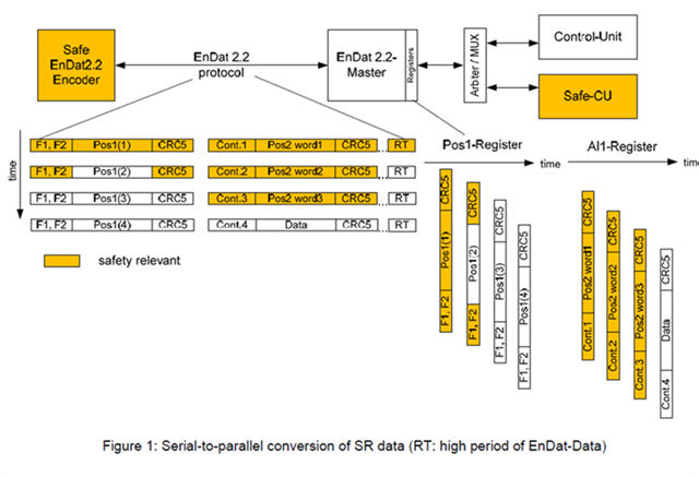

    1. In existing implementation of Endat2.2 master, does the master exposed raw data from the encoder to the user
            Raw data refers to : F1,F2, POS1 , CRC5 , CONT1 , POS2 WORD1, CRC5
