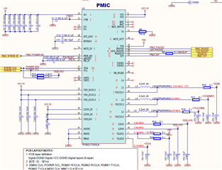

  • Hi Hong,
    Could you help me check the dts file on power section described correctly or not?
    Please see attachment. Thanks a lot.
    Note: The PMIC is TPS65217 so I reference the am335x-bone-common.dtsi to finish it.

  • Hi Hong,
    I noticed when the board stuck at "Starting Kernel...", the VDCDC2 which is vdd_mpu should be 1.26V but it's 1.1V.
    Is it the root cause that the board cat not get into kernel?
    I'm looping in my colleague to follow up on "Starting Kernel..." issue.
    -Hong
