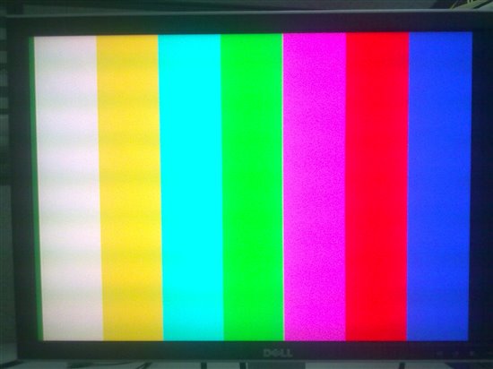

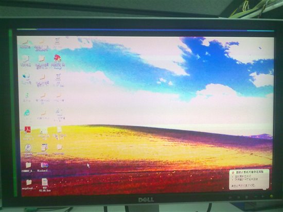

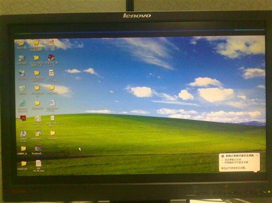

HELLO ,I  use th dvsdk 4.02 ,
my project is "dm365+ths8200+ths7303"  VGA output 1280x720p
I change the
davinci_platform.c ->davinci_enc_priv_setmode
and add the ths8200.c driver , i have already get 720p VGA video,
but i found the video clolor is wrong,my program is :
