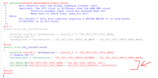

Hi Expert.
I meet one issue:see following log with red color.
Could you give me some hint?How to fix this problem?
I use SBL to boot "can_boot_app_mcu_rtos_mcu1_0"
use "can_boot_app_mcu_rtos_mcu1_0" to boot  "mpu_1_0 bootloader"
NOTICE: BL31: v2.4(release):08.00.00.000-dirty
NOTICE: BL31: Built : 03:45:52, Dec 14 2021
ERROR: GTC_CNTFID0 is 0! Assuming 200000000 Hz. Fix Bootloader
U-Boot SPL 2020.01 (Mar 04 2022 - 14:23:23 +0800)
SYSFW ABI: 3.1 (firmware rev 0x0015 '21.9.1--v2021.09a (Terrific Lla')
