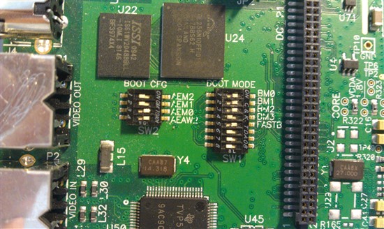

  • I have tried to use bootload the led_test program to the EVM board. To achieve this i generate an AIS script with the genAIS perl script distributed in the zip file with SPRAAG0D. I run the genAIS script with the following arguments:
    perl genAIS.pl -otype bin -i led.out -o led_nand.bin -bootmode nand -cfg ..\evm\evmdm6437.cfg (I've tried both with and without the config script -cfg)
    I then download the AIS file by placing it on the base of my C-drive and run the NANDwriter project. I import the project into CCSv4 and run the code in the debugger. When running this project it asks for a file to download where I write
    c:\led_nand.bin
    It then downloads the program and writes that it has been succesfully downloaded (i see the program chip-select the NAND device with my oscilloscope).
    When I power-cycle the device I again see that the NAND device is chip-selected a number of times, but the LED's doesn't change as they are supposed to.
    The Boot-setting switches are set as can be seen here
    Can anyone tell me how to further debug this issue?
