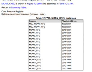

    Hi TI,I want to know how to be sure that the corresponding MCAN modules are enabled.
    You can read the MCAN_CREL (Core Release Register) to check if the module is enabled or not, an access to the MCAN_CREL for a MCAN module which is not enabled will lead to a crash. If the module is enabled, this register will give you a valid value.

  • mcan core register address
    The pictuer adove shows the picture of address

    I use devmem2 to get the value of main mcan1 register.I can get the value of this register(0x02701000)
    mcu register access
    but I can't get the value of this register(0x40528000),so I can't figure out how to make sure the mcu mcan are enabled??
