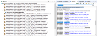

    2) Please confirm if SR2.1 is HS or Non-HS silicon
    I can confirme that we have Non-HS silicon on our boards (see picture below)

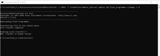

  • Hey Novica,
    My name is Andrew and I would be more than happy to assist you with this!  I have been investigating your problem extensively, and I am excited to report that I have successfully flashed the proper SBL binary, using the same silicon revision evm as you, with Uniflash version 6.1.0, pdk_am65xx_1_0_7. Here is the procedure I employed on Windows:
    C:\ti\uniflash_6.1.0\processors>ProcessorSDKSerialFlash -c COM23 -f FlashWriter\am65xx_idk\uart_am65xx_idk_flash_programmer.tiimage -i 0
    ProcessorSDKSerialFlash CLI Tool
    Copyright (C) 2017-2020 Texas Instruments Incorporated - http://www.ti.com/
    Version 1.3.0.0
    Downloading Flash Programmer..
    Transferring File of size 161612 bytes
    File Transfer complete!
    Enabling SysFw transfer!!!
    Header Transfer complete
    Transferring System Firmware..
    Transferring File of size 263072 bytes
    C:\ti\uniflash_6.1.0\processors>ProcessorSDKSerialFlash -c COM23 -f C:\ti\pdk_am65xx_1_0_7\packages\ti\boot\sbl\binary\am65xx_idk\ospi\bin\sbl_ospi_img_mcu1_0_release.tiimage -d 3 -o 0
    Version 1.3.0.0
    Transferring the Image to Flash Programmer..
    Transferring Header Information..
    Header Transfer Complete!
    Flashing Image of size 136135 bytes
    Flash Programming Success!
    After reviewing this thread, I do have one question, which version of Uniflash are you using?
    Andrew

    3) I read Silicon Revision Register and in the picture below you can see the content of this register
     I made the test again and I can confirm that our custom board with SR2.1. always failed at beginning of loading of SYSFW.
    Maybe you can try to set boot pins on your EVM board with AM6526 SR2.1. as we did on our custom board, and then you can do a test. If that test passes without any problem then the second option is to temporarily desolder OSC1 and WKUP_LFOSC and leave only the WKUP oscillator and then try to do the test again.

  • Hi Andrew,
    So I tried the bootmode setup you are using, on the SR2.1 revision evm you are using, and still don't see the error you encountered.  I know earlier in the thread you mentioned using a baud rate of 230400, is this still the case or in your latest response were you using 115200? Also, is there currently a Linux SD card inserted in the board?
    So the issue with the wrong baud rate occurred when I try to load flashwriter application via CCS, but this does not represent an issue anymore for us, now I can load flashwriter application to R5 core, and then I can use the Uniflash tool to write the image to NOR flash without any problem on our custom board with SR2.1.
    But we still have the issue after flashwritter application is loaded by ROM bootloader!
    We are using the Uniflash tool to write images (SBL, SYSFW and APP) to NOR flash, and we didn't have any problem using this tool on our board with SR2.0.
    But on boards with SR2.1. the Uniflash tool does not work. When Flashwriter application is loaded to R5 core, the problem occurs when sysfw header frame is sent then the target responded with 0x18.
    The other strange thing on SR2.1. is while receiving the header sequence, in parallel the R5 is sending character 'C' (0x43), and the problem with that is that this sending is not triggered by Flashwritter application on R5. (see picture below)
    The problem occurs when sysfw header frame is sent from the PC (uniflash tool) then the target responded with 0x18, more details you can find in my first posts above. You can see from the logic analyzer which data are sent on the UART line and what is received on the Sitara side on the board with SR2.1.
    So the problem on the board with SR2.1. is that some bytes that are received on MCU_UART are corrupted.
    On boards with SR2.0. we don't have this issue, but on all boards with SR2.1 we have this issue, and the silicon is the only component that is different between boards.
    In your latest reply, you mentioned Uniflash 6.1 and 6.4, are you saying the error being encountered is the same with each version?
    We have the same behavior with both Uniflash tool versions. From my point of view, this problem is not related to the version of Uniflash tool, it is related to the Sitara SR2.1 in the step after ROM bootloader finished loading of flashwriter application, the problem occurs in the first received xmodem frame  (the bad CRC is detected and the target board respond with 0x18)
