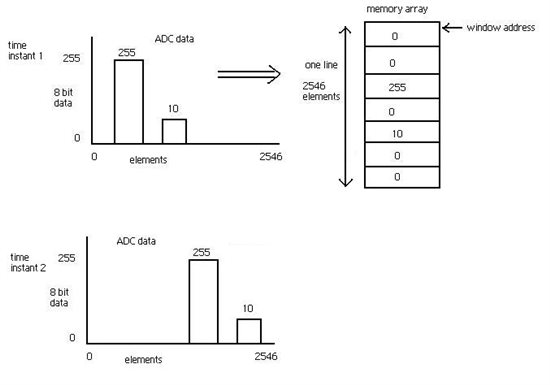

  • Hi Joe,
    Thanks for getting back to me quickly.  I have an ADC that we can for the moment assume is outputting constant data at a fixed frequency.  It outputs 2546 elements at 750Khz.  The data resolution is 8 bits.  It looks something like the figure below:
    If the ADC is outputting constant data as shown in the top graph, the data in the buffer fills up with the same data each time and appears to be stationary if I graph the input buffer that starts at (window address).  This is what I see if I setup 1 buffer equal to 1 line of data.
    When I add a 2nd data buffer, the data appears to shift as shown in the lower graph even if the ADC is outputting the same data at the same fixed frequency.  It appears to shift or actually rotate in and out of the buffer[0] if I setup up buffer[0] and buffer[1] with the keyword define# NUM_BUFS 2.  The ADC issues UPP_EN and UPP_START at the beginning of each frame of data.
    I am hoping to fill buffer[0] with 1 full data frame and then buffer[1] with another full data frame.  If the data coming in is constant, I should have 2 buffers that look like the top graph.  Please let me know if I am going about this wrong.
    Conrad
  • Hi Joe,
    I think I figured out the problem.  The shifting of data was happening because the input start signal was not operating correctly.  I found a workaround by driving the start signal with a separate GPIO output signal.  This way, when the application is ready to receive a new line of data, it syncs with the first word of data instead of doing whatever it was doing before.
