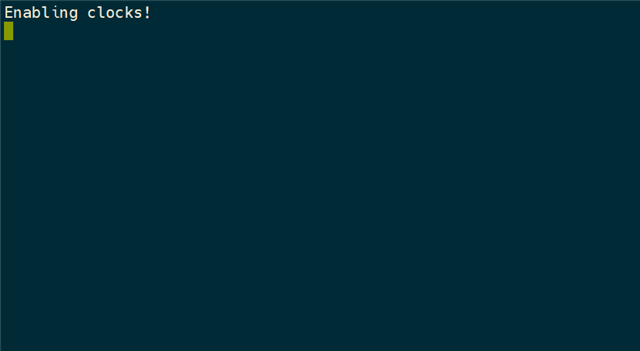

    I boot the board with the SD card and only one log "Enabling clocks!" is printed on the screen and it's stuck there. I tried different SD cards which all works well before but I get the same log and result. Besides, all the three leds besides the switch have the green light. Could please help me to figure out where the problem could be. Thanks a lot!

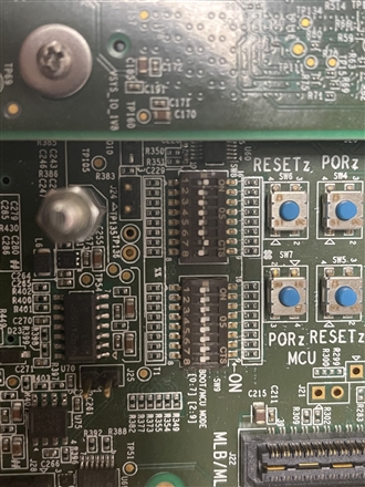

  • Hi Terry,
    Can you share the dip switch settings on your board? Are you booting SBL?
    - Keerthy
  • Hi Keerthy,
        Here is the picture of the switch setting.
    This is MMC-SD boot mode. Thanks for confirming. If you have CCS can you connect to R5F or A72 and check where it is hanging?
    Seems like it might be damaged but just want to know where it is hanging. Also can you confirm that you are using /dev/ttyUSB0 for capturing trace?
    And you are using SBL or SPL?
    - Keerthy

    This makes it tougher. So which UART is getting the trace "enabling Clocks". /dev/ttyUSB0 ,1 2, or 3?
    Can you give a screenshot of the terminal as it comes exactly?
    - Keerthy
  • Hi Keerthy,
        I'm using the MobaXTerm on WIndows to get the track, the UART is the one beside the MCU UART and is the one that was able to show normal booting log. I'm pretty sure that I used the right UART.  BTW, about 20 seconds after I turn on the power switch, this log shows,
    This does not seem to be any trace related to Linux/U-Boot.
