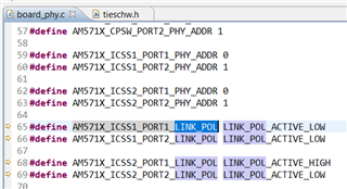

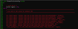

    I'm encountering a similar issue, just wanted to see if you've figured anything out since this was posted three weeks ago.  I did notice that the pinmux for PRU1 Eth0 is commented out in the PDK source under \pdk_am57xx_1_0_18\packages\ti\board\src\idkAM571x\idkAM571x_pinmux.c.  This likely has something to do with the issue.  I did try removing the comments and rebuilding the library /lib/idkAM571x/a15/release/ti.board.aa15fg, but that didn't resolve the issue for me.
  • Dear Ryan
    On our custom board changing the LINK_POL values for the MDIO initialisation solved the problem. I was not able to make the TI example work. In the example code the LINK_POL values are defined in tiesc_soc.h file. They are different for PRU Instance 1 and 2. I don't understand the reason for that. Maybe someone from TI can solve this question?
    Kind regards
    Marco
  • Marco,
    Thanks for the response!  Can you clarify exactly what LINK_POL values you used?  We're using a patch from TI that made some changes to LINK_POL and moved the values to board_phy.c to resolve a Lines Crossed Error.  My default values are as follows.
  • Dear Ryan
    I use the following configuration on our custom board:
      TIESC_WriteDWord((TIESC_TI_PHY_LINK_POLARITY_ACTIVE_HIGH << BOARD_ICSS_EMAC_PORT0_PHY_ADDR) |
                       (TIESC_TI_PHY_LINK_POLARITY_ACTIVE_HIGH << BOARD_ICSS_EMAC_PORT1_PHY_ADDR),
                       TIESCHW_ADDR_TI_PHY_LINK_POLARITY);
