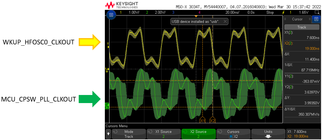

We compare the following two signals:
  • WKUP_HFOSC0_CLKOUT (CTRLMMR_OBSCLK_CTRL.CLK_SEL = 1)
  • MCU_CPSW_PLL_CLKOUT (CTRLMMR_WKUP_MCU_OBSCLK_CTRL = 0x00000908 e.g. CLK_SEL=8 (MCU_CPSW_PLL_CLKOUT 250 MHz) ; CLK_DIV=9 (+1 = 10 => 25MHz) )
According to the Clock Tree Tool, these two signals are input and output signals of the MCU_PLL1 correspondingly.
Placing the probes on the corresponding pins gives us the following picture:
As shown above, the output of the PLL has a measured jitter of 10 ns, which is considered much to high. We expect a jitter of a few ps.

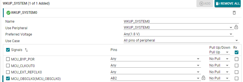

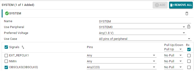

The board is initialized with the appropriate PINMUX settings:

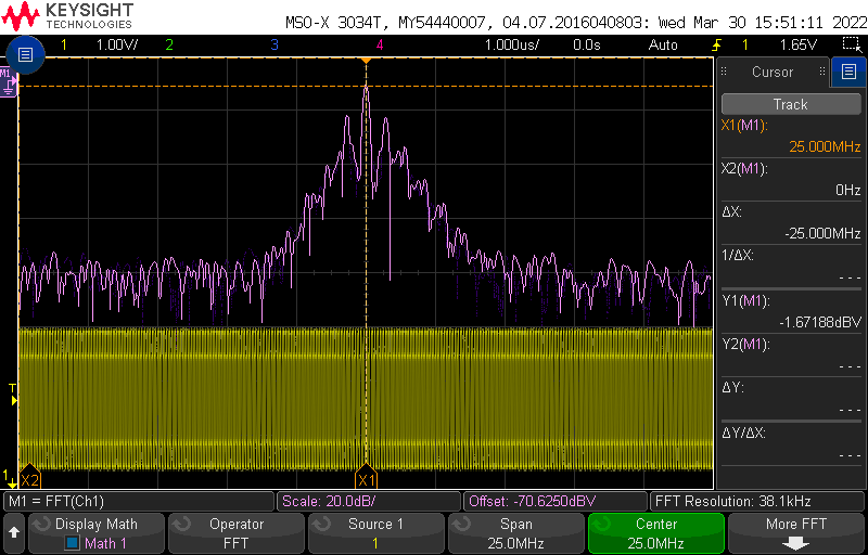

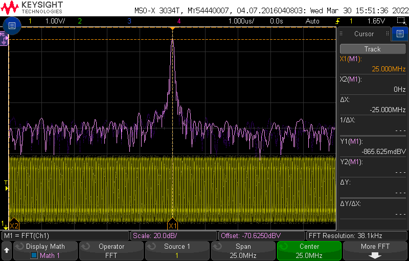

We also took two pictures of the signals in frequency domain:
Spectrum of the WKUP_HFOSC0_CLKOUT looks as following:
Spectrum of the MCU_CPSW_PLL_CLKOUT looks as following:
