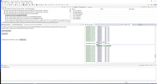

Here are some pictures when C7x abort on EVM
Here are some picture when C7x abort on our board
