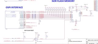

We are using DRA829V series HS processor with SR1.1 in out custom board. The part number is XJ721E5BALF. For OSPI booting, we are using CYPRESS flash device(S28HL512TFPBHI010). Initially we have flashed uboot image in 5 custom boards. In those 5 boards, no problems were faced and all booted properly. We have made some changes in uboot for software reset. We flashed that modified uboot image in OSPI flash of another custom board. After that that board booted two times. On third time,OSPI booting not happened. We booted in emmc mode and checked the flash using the  "sf probe" command. We are unable to read the JEDEC id for the flash device. So booting is not happening through OSPI flash and also flash is not accesible for read and write operation. I  have attached the OSPI section schematics and  observed log. Please support any solution to fix this issue.

    Regarding the above mentioned query, We have observed Glitch in D2 data line with an amplitude of 3.3V during SPI,xSPI mode for CYPRESS Flash. In eMMC mode, glitch was reduced to 1V. But on the other data lines D3,D4 no glitches were observed. We have made external pullups as unpopulated. We don't know why glitch is coming at only D2 line.

  • First I want to establish if there is a real correlation between the failure and the glitch on D2.  It sounds like you still have 5 boards (or is it 4 boards?) with the old uboot image.
    1) Do you see the glitch on any of the good boards?
    Also, can you get a scope capture that includes the glitch on D2 and the CS signal?  I'd like to see that for both the failing board and a good board.
    2) Could you explain the green line in your scope captures?
    The label is VCC, which implies that it is one of the power signals, possibly VCCQ_IO_3V3.  But I would expect the power supply to be stable at 3.3V before any toggling on the data lines happen.  That is not what I'm seeing on the scope pictures.  I'm also not sure what is going on with the pullup resistors.
    3) Are pullups installed on D2?  Do you see the glitch on D2 with the pullup?  Without the Pullup?  Both?  Did you take the pullups off after the failures occured?
    I'd also like to establish whether there is a correlation between uboot image version and the failure.
    4) Is it still possible to flash the OSPI on the failing board?  If so, does the old uboot image recover the failing board?
    -Zack

    We checked with OSPI flash vendor CYPRESS. They have confirmed that the glitch on D2 line is not an issue since it is within the absolute max rating. But one nonvolatile reg Configuration_Register_3 bit 3 (CFR3N[3])  is being written as 1 in the driver code to select uniform sector mode. CYPRESS is telling that writing to a non-volatile register may corrupt the other internal registers in the flash.
    (Below is the comments given by CYPRESS for this reg.
    This bit changes sector architecture in the device which is always nonvolatile configuration option. If customer changes CFR3N once then they do not need to and they should not keep changing this nonvolatile bit or register at every power on. Since this is an NV change, the device will keep the configuration upon every POR. So customer should remove this NV change routine from POR cycle. We have volatile bit as read only because we don’t want customers to change the sector architecture frequently. Generally, customers changes the sector architecture once as per their requirement)

  • "CYPRESS is telling that writing to a non-volatile register may corrupt the other internal registers in the flash"
    Could Cypress elaborate which registers could become corrupted?  You should be able to write to the non-volatile registers without corrupting other non-volatile registers.  If the claim is that writing to non-volatile registers could corrupt volatile registers, and thus a reset is required after writing non-volatile registers, that would make sense.  And if you are writing to the non-volatile configuration register on every power up, then that could be the root cause of this problem.  I agree that it should only be done once.  Have you tried running the previous version of the flash driver on the failing board by booting through the emmc?  Then, can you comment out the non-volatile register write and run that on the failing board?

  • I'm working with some software experts to learn more about this non-volatile memory write, but you should be able to avoid it by commenting out everything in your picture underneath the comment "/*Set the uniform sector mode bit*/".  If it's been written correctly once, you shouldn't need that line any more.  You could also change SPINOR_REG_CYPRESS_CFR3N to CFR3V.
    I can't comment with certainty on the test coverage, but generally all SDK releases are tested on EVMs, and our J7200 EVM has a flash device very similar to the one you use. One hardware difference I noticed is that on the EVM has a 10K pull-up resistor on line D2, and only line D2.  If it's an easy change to make on your board, could you try adding that pull-up?
