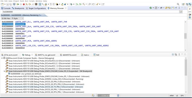

I am in  "NO BOOT" mode debugging the CR5 and strangely cannot access to UART0..UART2.
Any other peripherals are accessible but if I want to dump the UARTx registers with the debugger, the system hangs.
Is there anything special to do? I check PDK but cannot see a hint.

    I am able to access registers for UART0 - UART2 from R5, without any issues.
    Can you please provide the following details:
    1) What application are you running on R5?
    2) Is there anything running on A53 core?
    3) Can you please share the screenshot of error you are facing?
    Parth
  • "NO BOOT" mode => A53 off, CR5 in lock-step mode (set by Trace32), no software running so far.
    CR5 accesses to the UART memory returns 0 no matter where I read.
    Debugger access causes system crash.
    You might be facing the issue because main domain in not powered up. UART0 - UART2 lies in the MAIN domain and if you just connect R5, it won't initialize the MAIN domain.
    You'll need to initialize the MAIN domain, either by using the GEL scripts or by loading some application on A53 using SBL in order to access peripheral registers from MAIN domain.
    Parth
  • But i2c and gpio is also in the MAIN domain and this are working.
    As I wrote, if I boot with u-boot (which runs on A53), the UARTs are working, but CR5 is switched of, and I cannot switch it on with the debugger.
    What is different from UART to I2C or other peripherals in MAIN domain?
  • Arg, the boot mode settings on the custom board where not related to the official boot mode settings. Thus what I thought is "sleep no boot" was actually eMMC boot.
    I found a different setting which is "no boot".
