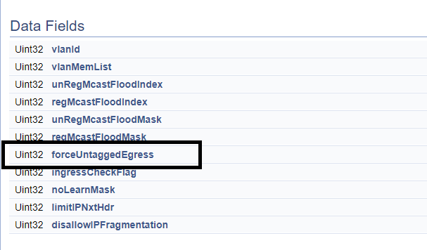

    1) UNTAG ethernet packets on ingress
    • From documentation link
      • I saw force untag packets on egress but couldn't find one for untagging vlan on ingress. Could you please let me know how to add support for this?

  • Swapna,
    I think the problem statement needs to be rephrased in terms of what CPSW supports. Let me try to explain what's supported.
    CPSW supports force untagging on egress.
    For untagged packets at ingress, port's default VLAN determines what VID and PCP values assigned at ingress. This default VLAN/PCP is passed via CpswMacPortCfg which is part of the PortLinkCfg struct:
    CPSW has 3 priority levels:
    So, if you want packets egress with priority 6, you will have to remap the needed priorities to header-packet-piority value of 6.
    -Misa

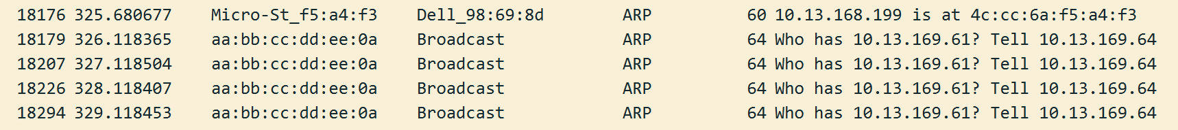

    Able to ping 8.8.8.8 and gateway 10.13.168.1 but pinging other DRA821 PCBA on same subnet with same SW changes(different mac) failed.
    We can see broadcast messages for PCBA1 on network but tcpdump on PCBA2 couldn't see ICMP BCAST messages.

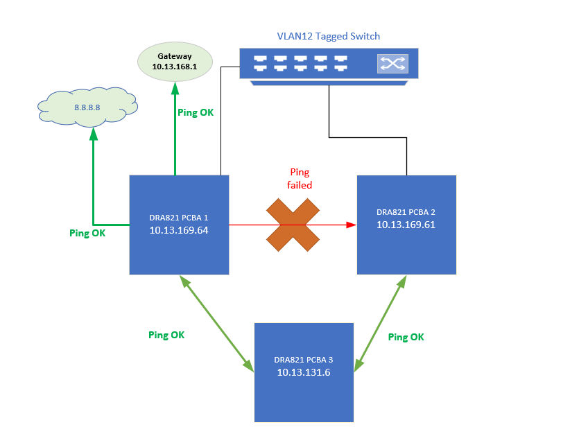

    • Looks like devices on same subnet with VLAN tags enabled cannot ping each other ( Broadcast traffic doesn't get passed through A72 )?
      • Documentation for SDK 8.1 says broadcast/shared multicast uses intercore virtual ethernet driver and broadcast traffic is routed from R5F_0 to other cores are there any filters based on subnet or should it be enabled from remote clients somewhere in code?
    • Please advise if TI has evaluated such usecase with VLAN's on same subnet using TISDK 8.1 QNX+RTOS image? This is gating our customer development and would appreciate your response.

  • Sapna
    Can you help summarize the exact use case needs.
    I see double headed arrows between PCB1<-->PCB3 and PCB2<-->PCB3, does this imply ping in both directions are working . and in case of PCB1-->PCB2, uni-directional ping fails.
    Is the QNX/VLAN SW configuration and ALE configuration identical across all the 3 instances of DRA821. For the ping traffic do you expect the traffic on the wire between the PCBs to be vlan tagged.
    Is any of the ping traffic passing through the vlan tagged switch and what is configuration at the switch side for such traffic.
    I feel the overall usage of vlan/subnet partitioning is not well understood in this case.
    The very purpose of using VLAN is restrict the broadcast domain - traffic including broadcast/multicast is confined to the respective VLANs alone and not forwarded outside the VLAN. The general usage model is to group nodes under a subnet using a specific VLAN ID
    Can you review your use case needs from VLAN partitioning and usage perspective
    sriram
  • Thanks Sriram!
    • Please find the answers below
    All PCBA's above have the same SW loaded
    • Ping between PCBA1 and PCBA2 does not work in both directions
    • Correct the traffic is always VLAN tagged
    • Yes, the traffic is passing through the external VLAN tagged switch

  • Hi Swapna,
    As you may know, ARP request packets are handled by Ethernet Firmware on behalf of the remote clients (like QNX virtual client driver) which had registered their MAC address + IP address pair.
    This is implemented as follows:
    1. In hardware - using an ALE classifier to route ARP packets to an UDMA RX flow allocated by Ethernet Firmware solely for ARP traffic. I have verified this, and packets with and without VLAN are being routed to this RX flow.
    2. In software - packets received on this RX flow are passed to Enet LLD's lwIP adaptation layer, which ultimately passes the lwIP pbuf corresponding to the ARP request packet to EthFw for it to respond. This stage is described here: https://software-dl.ti.com/jacinto7/esd/processor-sdk-rtos-jacinto7/08_02_00_05/exports/docs/ethfw/docs/user_guide/ethfw_c_ug_top.html

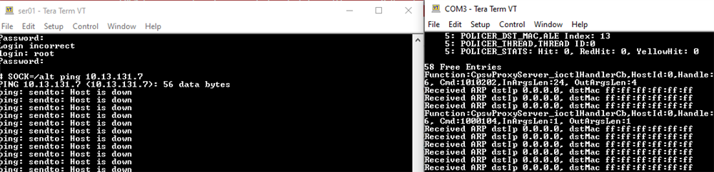

    To prove this theory, you can try rebuilding EthFw with ETHFW_CALLBACKS_DEBUG (ethfw/utils/ethfw_callbacks/src/ethfw_callbacks_lwipif.c). This will print a message for each ARP packet being received, and also will print a message if an response was sent. I believe you are going to see both prints.
    Now, the problem is that the ARP response sent in step 2 is VLAN untagged, so the response doesn't reach the original sender. This needs VLAN support enabled in lwIP (lwipopts.h) and EthFw needs to be able to pass the appropriate VLAN id in the response, etc. At this point I'm not sure if additional steps will be needed.
  • Thanks Misa!
    Step 2)
    I enabled this Flag and see LWIP layer is receiving ARP messages but no response.
    Received ARP dstIp 0.0.0.0, dstMac ff:ff:ff:ff:ff:ff
    As mentioned in setup above we are using two DRA821 PCBA's connected to same VLAN12 tagged switch and pinging from PCBA1 to PCBA2 when we see this issue. ( TISDK 8.1 QNX+RTOS )
