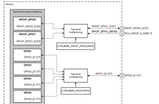

    According to the figure below, I seem to understand why you said to use the gpio4 pin.
    In tda4vm, gpio0, gpio2, gpio4 and gpio6 are integrated together.
    Then the figure below shows that I can use VGPIO_SEL to switch GPIO.
    But my question is how to modify VGPIO_SEL, and I found 173 CTRLMMR_PADCONFIG. Which one do I need to modify to switch to gpio4?

  • Hi Tao,
    This field is available in the pinmux register, so where you are setting pinmux, please update bit4 and bit5 to select GPIO module. Could you tell me which GPIO exactly you are planning to use ?

  • Hi Tao,
    GPIO0_127 is available on CTRLMMR_PADCONFIG128 (0x0011C200) and GPIO1_0 is available on CTRLMMR_PADCONFIG129 (0x0011C204). So can you please select VGPIO_SEL in this offset?
