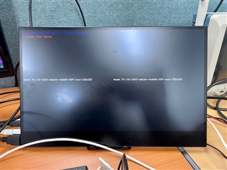

I tested EdgeAI Apps using 'single_input_multi_inference' config.

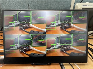

It works using single 720P video input → 4ch inference → mosaic display. but I changed input video 720P to 1080P, DL result don't display.
The app's log shows DL inference is working. like below:
[UTILS] [Model Name:   TFL-OD-2020-ssdLite-mobDet-DSP-coco-320x320] Time for 'dl-inference': 14.00 ms (avg 12.24 ms)
[UTILS] [Model Name:   TFL-OD-2020-ssdLite-mobDet-DSP-coco-320x320] Metric 'total time': 84.67 ms
[UTILS] [Model Name:   TFL-OD-2020-ssdLite-mobDet-DSP-coco-320x320] Metric 'framerate': 13.02 fps
[UTILS] [Model Name:   TFL-OD-2020-ssdLite-mobDet-DSP-coco-320x320] Time for 'dl-inference': 30.00 ms (avg 11.31 ms)
[UTILS] [Model Name:   TFL-OD-2020-ssdLite-mobDet-DSP-coco-320x320] Metric 'total time': 87.57 ms
[UTILS] [Model Name:   TFL-OD-2020-ssdLite-mobDet-DSP-coco-320x320] Metric 'framerate': 12.96 fps
[UTILS] [Model Name:   TFL-OD-2020-ssdLite-mobDet-DSP-coco-320x320] Time for 'dl-inference': 20.00 ms (avg 10.70 ms)
[UTILS] [Model Name:   TFL-OD-2020-ssdLite-mobDet-DSP-coco-320x320] Metric 'total time': 84.78 ms
[UTILS] [Model Name:   TFL-OD-2020-ssdLite-mobDet-DSP-coco-320x320] Metric 'framerate': 12.81 fps
[UTILS] [Model Name:   TFL-OD-2020-ssdLite-mobDet-DSP-coco-320x320] Time for 'dl-inference':  8.00 ms (avg 11.22 ms)
[UTILS] [Model Name:   TFL-OD-2020-ssdLite-mobDet-DSP-coco-320x320] Metric 'total time': 86.39 ms
[UTILS] [Model Name:   TFL-OD-2020-ssdLite-mobDet-DSP-coco-320x320] Metric 'framerate': 13.22 fps
And I tested '1080P video input → 1/2/3ch inference → mosaic display' and it works. so there is no problem in test 1080P video file.
Also I tested RTSP input instead of video file, but the result is same of using video file. 1080P input only work 3ch inference.
I know that TDA4VM has 'D5520MP2' decoder. It support 4x1080p60 and 8x1080p30 decoder. so I think it's not hardware problem.
How can i fix this problem?
Lee.

  • Hi Shyam,
    1. Processor SDK Linux for Edge AI 08.00.01
    2. I used C++ based app. Also i tested python based apps, the result is same.
    3. I executed the app with -n -l options.
    4. I used UART consol.
    I attached the c++ based app's log file.

    Lee.

  • Hi Lee,
    Can you set width as 1088 in the config file and try
    I observed that h264parse is aligning the 1080p buffers to 1920x1088
    Rahul T R
  • Hi Rahul,
    Did you mean output's width?
    I set output's width 1088 in config file, result is same. nothing to change.
    I attached file that used in my test(config.yaml, sample_fhd.mp4)
    Please check using this files.
    fhd_multi_test.zip.
    Lee.
  • Hi Lee,
    I meant the input width
    This will be used for some calculations
    please change input width to 1088
    Rahul T R
  • Hi Rahul,
    I modified input width 1080 to 1088, result is same. DL-inference result doesn't display.
    Can you test it with the file attached to the above article?

  • Hi Lee,
    Are you trying python apps or cpp apps
    Can you try with python apps with -n option
    and share the gstreamer pipeline printed on the console
    if you are using minicom, add -w option to avoid line wrapping
    I want investigate the pipeline constructed
    Rahul T R
  • Hi Rahul,
    I tried cpp apps. here is python app's log.
    root
    Last login: Thu Apr 14 05:55:57 UTC 2022
    root@j7-evm:/opt/edge_ai_apps# cd apps_python/
    root@j7-evm:/opt/edge_ai_apps/apps_python# ./app_edgeai.py -n ../configs/single_input_multi_infer_fhd.yaml
     Number of subgraphs:1 , 126 nodes delegated out of 126 nodes
    APP: Init ... !!!

  • Hi Lee,
    Your config file is working fine at my end
    can you please share how you scaled the video to 1920x1080
    I used below ffmpeg command:
    ffmpeg -i video_0001_h264.mp4 -c:v libx264 -bf 0 -vb 10000k -qmax 24 -vf fps=fps=30 -vf scale=1920:1080 -an video_0001_h264_b.mp4
    can you try with this?
    Rahul T R
  • Hi Rahul,
    I scaled the video HD to FHD using a regular encoder program. The FHD video file work well without 4ch.
    As mentioned, the attachment also includes a video file.
    hum... Seeing that FHD 4Ch works normally in your environment, I think there is a problem with my environment.
    I'll make new SD card and check it again.
    Lee.
  • Hi Lee,
    Which SDK version you are using
    8.1?
    My environment might be different
    than 8.1, I will give a try with 8.1
    Rahul T R
  • Hi Rahul,
    I use SDK v08.01.00.02.
    Lee.
  • Hi, update this thread.
    The SDK 8.2 was released.
    So, I tested 4ch inference with same setting on board that installed SDK 8.2. It works well.
    (1 FHD → 4ch Inference → Mosaic)
    I think it's a problem with some of the elements of SDK 8.1.
    Lee.
