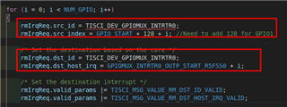

Hello Brijesh,
I don't understand this structure tisci_msg_rm_irq_set_req
Hi Zi Wang,
This is GPIO interrupt router which connects GPIO interrupt line to the irq line of the different cores.. It supports multiple GPIO input IRQ and 64output irq lines.. It is a configurable mux, so needs to be configured to connect GPIO irq to the one of the output irq. This is what is done by this API..

Hello Brijesh,
thank you for your reply.
Below is the code you provided before.
I know that src_id, src_index means:
But I don't know that dst_id, dst_host_irq means here,I didn't find this "rmIrqReq.dst_host_irq = 24" definition?
Hi Zi Wang,
In this case, please refer below link. It provides the dst_host_irq number.
software-dl.ti.com/.../interrupt_cfg.html
Brijesh
Hello Brijesh,
thanks for your help!
But I didn't find a definition of “24” in "GPIOMUX_INTRTR0 Interrupt Router Input Sources" and "GPIOMUX_INTRTR0 Interrupt Router Output Destinations"
and I don't understand what the link of this route looks like,in this code? GPIO1_35 -> GPIOMUX_INTRTR0_IN_163 -> ?
Hi Zi Wang,
did not get it, where am i using "24"?
GPIO Mux is multiplexer, which connects n inputs to m outputs..
what is GPIOMUX_INTRTR0_IN_163?
Brijesh
Hello Brijesh,
here i see GPIOMUX_INTRTR0_OUTP_START_R5FSS0 = 24
Hi Zi Wang,
That is 24th output line of GPIOMUX, which is connected to the irq line 184 of R5F.
GPIO_START=35 , src_index=35+128=163,I think it's GPIOMUX_INTRTR0_IN_163
Yes, this is correct, GPIO1_35 is input to 128+35 number on GPIOMUX.
Brijesh
