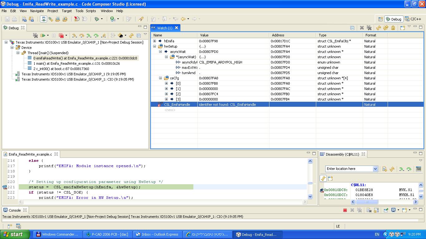

  • Hi Randy.
    I am sorry for the confusing information , I will try to make myself clear as possible.
    I intend to attach a CPLD to the emif bus , Currently the emif connecotr is not connected to any hardware.
    All I need at this moment all I need is to see that the emif is active .
    Now for the test , I followed your advise and I breakpoint on the line
     status =  CSL_emifaHwSetup(hEmifa, &hwSetup);
    I can see that something with the structure is wrong .
    Please Advise.
    Thanks.
  • Ephraim,
    I hope you are willing to laugh at my bad advice. I have seen many pictures inserted into posts that allowed me to expand it enough to see the numbers and text, but this one is not clear enough. I expanded it a lot in FireFox, but the blurs got larger. I do not know if the problem is with using .jpg instead of .bmp, or with inserting an image instead of attaching it, or just the fact that I wear trifocal lens glasses. But I cannot read enough of your Watch (2) window to guess what data are in the structs.
    If you are willing to help me understand the problem with the image, please do me this favor in your next post. Please use the convenient you used above to include the .bmp version of the file, and also do the previous method to include a zip file with both the .bmp and .jpg versions. I apologize for the bad advice, but I will be much smarter about this if you can do these for me.
    Please open more of the embedded structs, too, please. You can click on the + signs a bit deeper to get more information in the Watch (2) window.
    This is good news. And the fact that your CPLD is not yet connected eliminates a lot of the debug direction I was considering before. And it shows that you and I are alike in trying to take one step at a time.
    Since you see something wrong with one of the structs (I assume hwSetup since you have it highlighted in the source window, but I am guessing still), you can look back through your code to see when the wrong field values were written and determine why or what needs to be done differently.

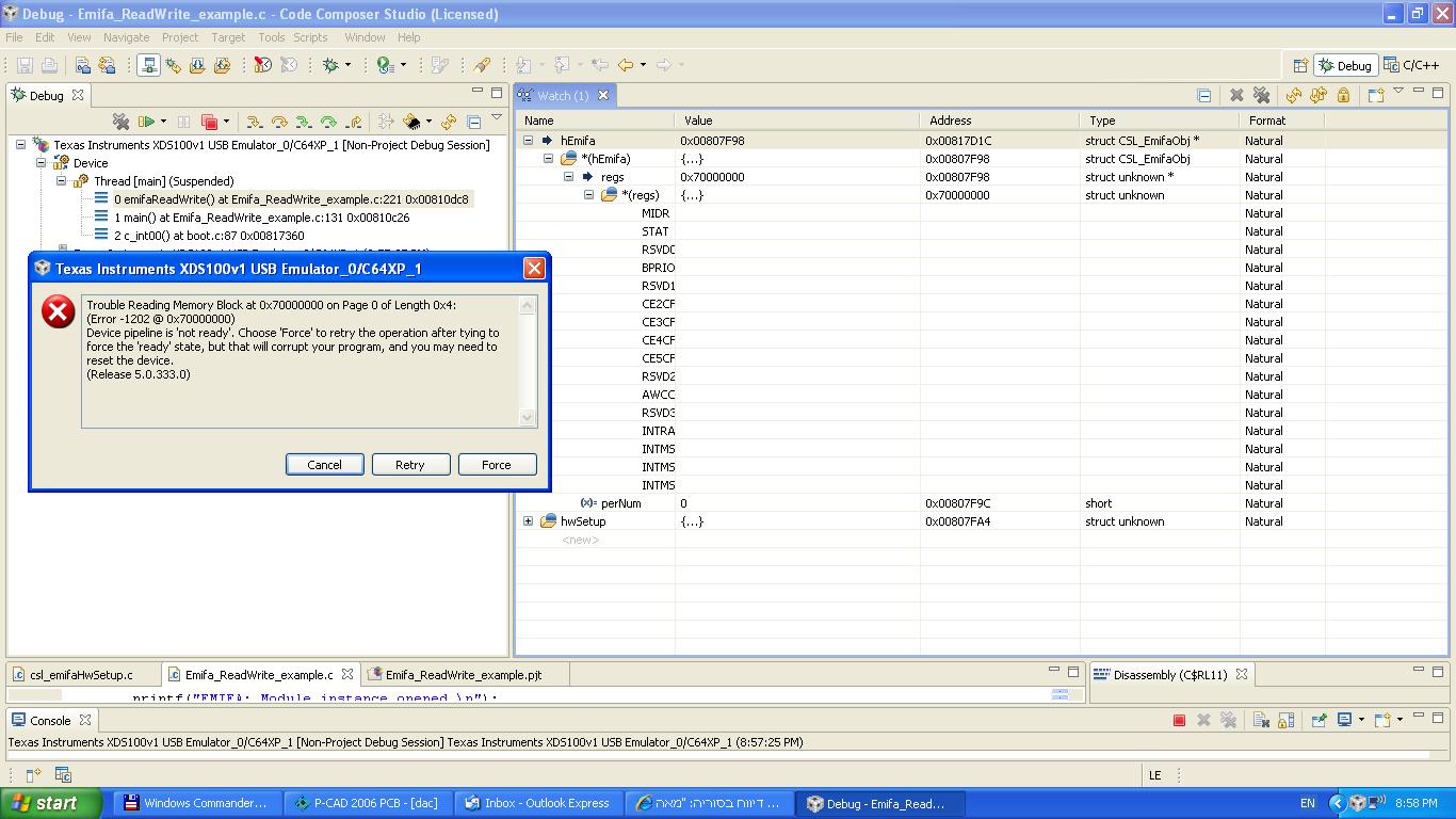

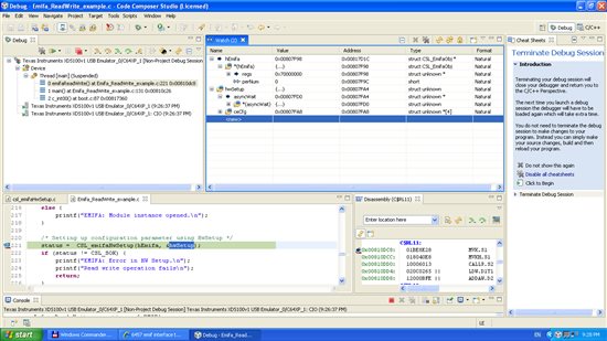

  • Hi.
    I am not laughing at all , I just want this nighmare over .
    Attached 2 jpg screenshots .
    The left notification pops up as I expand the hEmifa regs.
    See that the regs type in unknown , I don't understand what it means.
    The same "unknown structure" happens with the hwsetup structure.
    Please Advise.
    Ephraim Oved.
  • Whatever you did differently worked well for the jpg's. I was able to expand them large enough to read this time. Thank you.
    For the first picture, showing hEmifa, this is troubling that you cannot read from 0x70000000. Please try directly reading it at different points in your debug flow, such as immediately after connecting and/or reset, after loading and running to main(), even at the same point in your program. Try reading by either using another watch window on *(int *)0x70000000 or a small memory window at that address.
    For the second picture, showing hwSetup, ceCfg[1] and [3] are NULL, which I doubt is what you intended. Please look at where you set the values in hwSetup and make any corrections needed. At the least, you can set asyncWait = NULL since you are not using ARDY; this will change the location of the failure, but will probably not get rid of it.
    Whatever is causing you to be unable to read from 0x70000000 is what will likely turn out to be the problem here. But that could be an initialization problem related to powering up and clocking the EMIFA peripheral. Please double-check what you have done there, and try to find a working example from the support examples.
    I know this is not a lot of help, yet, but you are making progress toward finding the problem.
