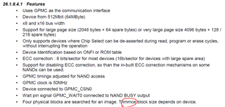

#1. What is mean of "Thmmce" in NAND boot feature list?

  • Hello Tony,
    I think that is a typo, where "Thmmce" should be read "the". I am reassigning to our ROM owner to comment on the other questions.
    Nick
