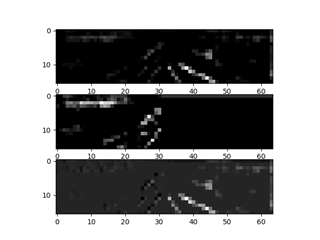

Hi Everyone,
While debugging our custom NN import to TIDL we experienced faulty TIDL execution for asymmetric resize layers. We ran the model and dumped the tensor values as float from with our own ONNX PC execution and compared them with the TIDL PC emulation in float mode for the same input. We calculated the differences from the reference tensor values and found that asymmetric resize layers produce wrong outputs in TIDL.
Running the PC float emulation, the asymmetric resize is executed in a symmetric way, and the asymmetric component is replaced with zero padding. In the picture below you can see the output of the first asymmetric resize layer in our network (asymmetry is 2-1 in width). Top tensor is the correct value taken from our ONNX run, middle tensor is the TIDL execution output, bottom tensor is the difference plotted as n image. We think this is a bug with asymmetric resize implementation in TIDL.

    When you say asymmetric, does it mean that only one dimension is getting expanded ?  I guess it is 2x expansion in width direction in your case and no expansion in height direction.. If so then this kind of asymmetric resize is currently not tested/targeted, however we are looking into this issue to reproduce this issue here.
    If possible please point to the network where this kind of resize is used, this will help in testing.

  • Hi Deepak,
    I can't share our whole network but I could create a small one layer reproducer for you that reproduces the issue. The problem happens in asymmetric downsample cases. It looks to me that half of the tensor is filled continuously with the middle row/column values producing incorrect output.
    The example network takes a 1x32x32 input and downscales 2-1 ratio. I attached the reference output from onnx execution with nnef_tools and TIDL PC emulation below. I also attached the network and import/inference configuration in a zip file.
    Input tenzor:
    Output of neef_tools:
    Output of TIDL execution:
    The same happens in width direction as well:
    I would also like to point out that TIDL model importer only gives a warning as non-symmetric resize is not optimal which is quite misleading as they are not supported/validated. This error message suggest that they should work but they will be slow. That is clearly not the case.

  • Regarding asymmetric resize, since TIDL-RT natively doesn’t handle it, we suggest to use open source run time interface (TFLite RT or ONNX RT) which will allow asymmetric resize layer to run on ARM.
