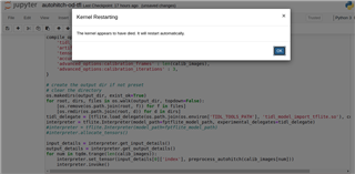

I am trying to evaluate Object detection model performance on TI Edge AI. I have been getting some weird issues.
  • Sometimes the Kernel dies when compiling the model.
  • While compiling bad alloc issue came a couple of times at line "interpreter = tflite.Interpreter(model_path=fptflite_model_path, experimental_delegates=tidl_delegate)"
  • If the compilation is successful then I am getting No module named tflites.utils
Kernel Died
  • Error No Module named tflites.utils

  • Hello Paula,
    Thanks for the reply. I switched the notebook. I still have the kernel dying issue though. could you please help me to understand the issue? Please find the attached log.

  • Akash, sorry for the delay. I was wondering if you can also compile this model using our github edgeai-tidl-tools
    The reason is above log is not completed (probably because the kernel died).
    Alternatively, if you can share this model with us we can test it.
    There is a potential issue with TFLite and Relu6. But we would like to confirm.
    thank you,
    Paula
  • Our's is a custom tflite model. I am trying to compile the model using the mentioned repo but I am not able to. I tried using this script python3 tflrt_delegate.py -c with my model. But getting errors that the "frozen inference graph is not available in config". Could you please provide me an example of how to do this?

  • Hi Akash, my bad, I missed the second log before. We will take a look.
    Thank you,
    Paula
  • Hello Paula,
    Any updates?
    Thank You,
    Akash
  • Hi Akash, perfect timing =). I was about to update you. We got a potential fix. I will share with you a new tidl_model_import_tflite.so w/ this patch. I will target send it soon (next few hours).
    thank you,
    Paula
  • Sounds good thank you.
  • Akash, can you send me your email address? in order to invite you to a ti.box share folder
    thank you,
    Paula
  • Hi Paula,
    It is achavan8@ford.com
  • Akash, you will get an email to accept ti.box. Let me know if you face any issues downloading the lib.
    After downloading patched TIDL model import libs please replace them inside edgeai-tidl-tools "tidl_tools" folder and re-test your model. Please let us know if compilation is successful and if you can run inference.
    thank you,
    Paula
  • Paula,
    I am seeing the same behavior with new libs. The model doesn't compile. Below is the log
    python3.6 tflrt_delegate.py -c
    Running 1 Models - ['od-tfl-20220331_frozen_inference_graph_8b']
    Running_Model : od-tfl-20220331_frozen_inference_graph_8b
    Warning : concat requires 4D input tensors - only 3 dims present.. Ignore if object detection network
    Number of subgraphs:48 , 163 nodes delegated out of 211 nodes
    ************** Frame index 1 : Running float import *************
    WARNING: [TIDL_E_DATAFLOW_INFO_NULL] ti_cnnperfsim.out fails to allocate memory in MSMC. Please look into perfsim log. This model can only be used on PC emulation, it will get fault on target.
    ** 1 WARNINGS 0 ERRORS **
    0.0s: VX_ZONE_INIT:Enabled

  • Hi Akash, it is still creating 48 subgraphs.. It is any way you can share this model with us? or a way to reproduce it (maybe a cut version of your model)?
    thank you,
    Paula
  • Hello Paula,
    I have uploaded the model file to ti.box.
    Akash
  • Hi Akash, can you send me the link? I don't see it
    Thank you,
    Paula
  • Paula,
    Could you please give me your email address?
    Thanks!
    Akash
  • My email address: p-carrillo@ti.com
    thank you
    Paula
  • Hi Akash, let me give you some updates. From shared model we see there are some "FakeQuantWithMinMaxVars" nodes which are not supported. This seems to be the cause of 48 subgraphs being created even after shared Relu fix.
    We support maximum 16 subgraphs in TIDL, however, the rest of the subgraphs should have run in ARM. We need to check why it is not the case.
    In any case, running 16 subgraphs and the rest on ARM probably will have a huge performance penalty. Therefore, do you think "FakeQuantWithMinMaxVars" could be replaced for some other supported operator(s) in TIDL?
    thank you,
    Paula
  • Hello Paula,
    Thanks for the update. I will check internally how to proceed and let you know.
    Thank you,
    Akash
