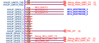

     We made a custom board and try to bring up.
     The port of Main_Uart0 is used to com with other chip.At first,the two wires of Main_Uart0 are connected out and the sdk is Ver 08_02
_00_03. It boot up successfully and log are printed out via Main_Uart0.Next we need to change the console port.
     I follow the steps to change the default console Uart from Main_Uart0 to Main_Uart5:
https://e2e.ti.com/support/processors-group/processors/f/processors-forum/988278/faq-tda4vm-j721e-j7200-how-to-switch-console-to-a-different-uart-instance?tisearch=e2e-sitesearch&keymatch=How%2520to%2520switch%2520console%2520to%2520a%2520different%2520UART%2520instance#
     Here is the HW design:

    Are you getting any logs on the console? Which SDK are you trying this?
    - Keerthy
  • Hi ,
    Thanks for replying.
    No log printed out,SDK version is 08_02_00_03
    No signal can be detected on Main_Uart5 Tx wire via oscilloscope.
    I believe the clocks are not turned on at the R5 SPL level. There is an internal issue that is being worked upon. I will update you as soon as there is some progress on this.
    - Keerthy
    Thanks for your support.Looking forward to your reply!
    This is also noted in the release notes for 8.02 SDK: software-dl.ti.com/.../Release_Specific_Release_Notes.html
    I am checking internally but this will take time and will be coming next release hopefully.
    - Keerthy
    In this release(08_02),does it worked if i change the console of uboot and kernel to other Uarts in MCU or WKUP domain?
    Here is the HW design of debug Uart.
    Thanks~
    I tried to change the console port to Main_Uart5(ttys7) for kernel.Now it can print out boot log successfully via Main_Uart5.
    But here comes the new bug,when I want to login with name "root",it comes out "Login incorrect".
    Login is correct when the console is Main_Uart0.
    Here is the boot log when the console port is Main_Uart5:

    This is good progress. So does the same SDK work well with default main_uart0? I mean no login issue?
    - Keerthy
    It works well with Main_Uart0.I can login successfully.(SDK version 08_02_00_03)
    Thanks~
    Can you share the code changes you did to get this working? I will review that.
    Keerthy
    Sorry for late.
    Here is my changes:
    diff --git a/include/configs/j721e_evm.h b/include/configs/j721e_evm.h
    index 614d032538..ff5968f479 100644
    --- a/include/configs/j721e_evm.h
    +++ b/include/configs/j721e_evm.h
    @@ -85,8 +85,8 @@
                            "setenv name_fdt k3-j721e-sk.dtb; fi;"  \
                    "setenv fdtfile ${name_fdt}\0"                          \
            "name_kern=Image\0"                                             \
    -       "console=ttyS2,115200n8\0"                                      \
    -       "args_all=setenv optargs earlycon=ns16550a,mmio32,0x02800000 "  \
    +       "console=ttyS7,115200n8\0"                                      \
    +       "args_all=setenv optargs earlycon=ns16550a,mmio32,0x02850000 "  \
                    "${mtdparts}\0"                                         \
            "run_kern=booti ${loadaddr} ${rd_spec} ${fdtaddr}\0"
    diff --git a/include/environment/ti/boot.h b/include/environment/ti/boot.h
    index a4d22c56bd..f1b045a901 100644
    --- a/include/environment/ti/boot.h
    +++ b/include/environment/ti/boot.h
    @@ -12,7 +12,7 @@
     #include <linux/stringify.h>
     #ifndef CONSOLEDEV
    -#define CONSOLEDEV "ttyS2"
    +#define CONSOLEDEV "ttyS7"
     #endif
     #ifndef PARTS_DEFAULT
    diff --git a/arch/arm64/boot/dts/ti/k3-j721e-common-proc-board.dts b/arch/arm64/boot/dts/ti/k3-j721e-common-proc-board.dts
    index 7e9490fcb..fa64d8eec 100644
    --- a/arch/arm64/boot/dts/ti/k3-j721e-common-proc-board.dts
    +++ b/arch/arm64/boot/dts/ti/k3-j721e-common-proc-board.dts
    @@ -13,9 +13,9 @@
            chosen {
    -               stdout-path = "serial2:115200n8";
    +               stdout-path = "serial7:115200n8";
                    /*bootargs = "console=ttyS2,115200n8 earlycon=ns16550a,mmio32,0x02800000";*/
    -               bootargs = "console=ttyS2,115200n8 earlycon=ns16550a,mmio32,0x02800000 root=/dev/mmcblk1p2 rw rootfstype=ext4 rootwait";
    +               bootargs = "console=ttyS7,115200n8 earlycon=ns16550a,mmio32,0x02850000 root=/dev/mmcblk1p2 rw rootfstype=ext4 rootwait";
            gpio_keys: gpio-keys {
    @@ -438,7 +438,9 @@
     &main_uart0 {
    -       power-domains = <&k3_pds 146 TI_SCI_PD_SHARED>;
    +       /* UART not brought out */
    +       /*power-domains = <&k3_pds 146 TI_SCI_PD_SHARED>;*/
    +       status = "disable";
     &main_uart3 {
    @@ -448,7 +450,10 @@
     &main_uart5 {
    -       status = "disabled";
    +       pinctrl-names = "default";
    +       pinctrl-0 = <&main_uart5_pins_default>;
    +      power-domains = <&k3_pds 282 TI_SCI_PD_SHARED>;
    +       status = "okay";
    Hope it will help.
    Thanks!
    I am yet to reproduce this. Let me know if you have any further updates.
    - Keerthy
    Boot with ttyS2 i.e with main_uart0 & change the file in your filesystem:
    /etc/securetty
    It only has ttys0, ttys1, ttys2, ttys3. So please add ttyS7. You should be able to boot with ttyS7 i.e main_uart5 &b login.
    - Keerthy
