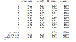

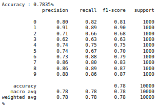

    For sure, I measure the accuracy of my model using sklearn.metrics.classification_report and scikitplot.metrics.confusion_matrix.
    Here you can see the results I obtained using the model on PC :
    Here you can see the results I obtained using the model on ARM :
