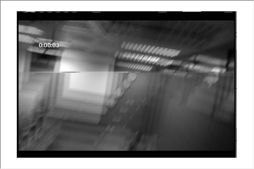

Hi all,
    I am using DM6437 connect with TVP5158 decoder to get 2-ch D1 image(line-interleaved mode).
1. Since the vertical blanking in the input is being masked out, we can only get the V-bit in start code(SC[0]) to indicate the end of the frame(it will cause 4 times in ),
    is that possible we can get the VDINT interrupt signal from VPFE(to check the end of the frame by hardware, not by software)?
2. When I read the image data in beginning of the SDRAM(or in the same address), every times I will get the different line number, is that correct?
After the de-multiplexed procedure, i will get the image like this:
It's seem like some of the lines are copied from the next frame, is there any way to solve the problem like this?

     you can use VDINT0 and VIDINT1 of VPFE.
    Can you explain(rephrase) in detail what you mean?
    And yes, looks synchronization is not handled properly, hence frame is like that.

    1. After I tested the VPFE interrupt, I find out it will caused the interrupt about 30 times per second, but I'm not sure whether it's indicate the end of the frame,
       because I can't figure out if the vertical blanking in the input(SAV/EAV) is be masked out, what will cause the VPFE interrupt?
    2. For example, the first time input image line 1 is written to the SDRAM address 0x84000000, but in the next time, a random input image line will be written to the same
        address 0x84000000, not the same line number, it's mean the image data sorted in SDRAM will changed and I don't know why is that happend.
  • Mike,
    VIDINT Interrupts are configured for number of lines in a frame. For each frame, after number of lines, interrupt is triggered. ISR will handle that interrupt by doing appropriate action such as scheduling next buffer. In case you have a source for the driver, you can find about this.
    Regarding SDRAM address, yes, once a frame is captured, driver programs new address in hw so that next frame is captured in different location. SDRAM addresses are programed in hw during active period because registers are shadowed. They take effect only from next v-blank.
