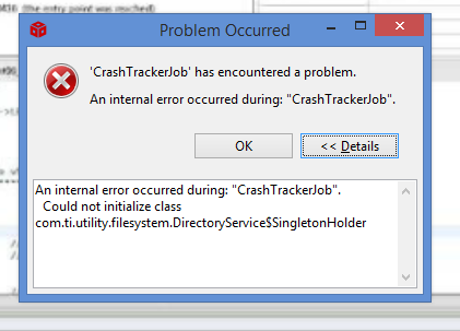

Now, when application opens at the very beginning a warning pops up which says "Trace back job error" and when i tried to import the projects CCS is not working.

    Regarding the "CrashTrackingJob" error, please see:
    https://software-dl.ti.com/ccs/esd/documents/users_guide/ccs_troubleshooting.html#missing-msvc-redistributable-libraries

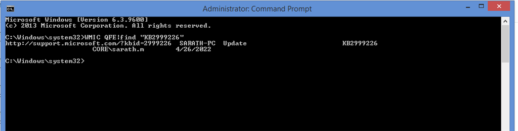

    I've followed the steps in the SDK-RTOS , Deleted the MSVC redistributables and installed them again , while re-installing an error came up to update the windows to KB2999226, so after research I've found the steps to do that:
    Installing the Windows8.1-KB2999226-x64:
    step 1: Install the Windows8.1-KB2999226-x64.exe from the www.microsoft.com/.../details.aspx
    step 2: Run the cmd as Admin
    cd C:\ProgramData\Package Cache\469A82B09E217DDCF849181A586DF1C97C0C5C85\packages\Patch\amd64\Windows8.1-KB2999226-x64.msu
    step 3: Extract the .exe files to a folder: XXXX by giving
    wusa.exe Windows8.1-KB2999226-x64.msu /extract:XXXX
    step 4: Run the below cmd
    DISM.exe /Online /Add-Package /PackagePath:XXXX\Windows8.1-KB2999226-x64.cab
    After that MSVC redistributables are perfectly installed, and I restarted the PC and opened the CCS but still CrashTrackerJob error shows up.
    So, I go for the second solution in the SDK guide, by giving command
    WMIC QFE|find "KB2999226"
    and this runs also fine, so I do the re-installation of CCSV9 and while installing an error window comes up
    I've tried to get the log but the folder is not there in the Local\Temp folder, I guess in it's own got deleted.

    and after that this shows up
    When i launch the CCS again "Trace back job error" comes up and unable to import the projects, I hope this time this info is helpful you to troubleshoot the problem and get the solution.
    Sarath
