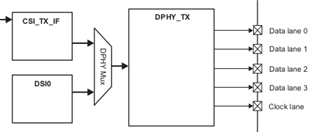

The output DPHY is shared between DSI and CSITX, so we can have either CSITX or DSI.
On the input side, there are two CSIRX supports, both can be supported simultaneously.

If I want to output two different pictures on two screens through two DSIs, is it ok?
Can CSI_TX be configured as DSI?
I see CSI_TX and DSI output on one DPHY_TX0
Hi Zi Wang,
No, DPHY_TX can either be used for CSITX or for DSI.. Both simultaneously cannot be enabled.
Instead of two DSI, can you consider using two channels in CSITX, differentiated with different virtual channel id? CSI protocol supports it..

My client has this requirement:
On R5, the two cameras are input through CSI_RX, and after the image is processed, they are output through two DSIs respectively (not DSI and SCI are directly connected)
Does the way you said above apply here?
This virtual channel id method uses one DSI hardware to virtualize two DSI channels?
Hello Zi Wang,
There is only one DPHY, so two different DSI outputs are not available on TDA4VM.
Yes, each channel is identified using an id, but still uses same CSITX port..
