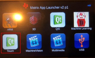

Q2:I would like to evaluate the flick-swipe operation, is there any samples, etc.?
The SD card that came with EVM had a GUI demo for flick-swipe operation, but it does not seem to exist in the default image of this SDK.

    I am not sure what swipe app you are looking for but the following directory have a few touch related tests: usr/share/qt5/examples/widgets/touch
    Krunal
  • Hello  Krunal,

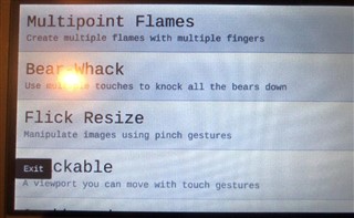

    Thank you for your reply. The demo of what we are looking for worked with SDK version 05.02.00.10. The touch demo is shown below.
    As an additional question, the above demo could not be launched with SDKv06.03.00.106 and v07.03.00.00.005. Are these caused by something on the test application side? Or are they related to the Weston issue you previously answered?
    The specific situation is as follows.
    (1) Start matrix-gui-2.0 and the menu appears.
    (2) When the touch test application icon was touched, the screen went dark.
    (3) After a while, the menu of matrix-gui-2.0 is displayed again (loop).
    (In case of SDKv05.02.00.10, the touch test application started normally.)
    O.H
    The touch demos came from Qt's website and it's not something we implemented. If you still see the source code on Qt's website, you could try to compile it with newer SDK.
