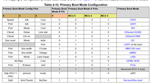

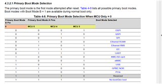

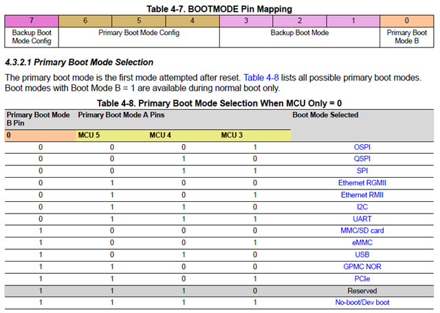

    I understand that the default boot mode setting for the EV board is SD card boot mode with SW8 & 9 settings as shown below:
    SW8: 10000010
    SW9: 00000000
    However, when I refer to Table 4-8 from datasheet (spruil1c.pdf) attached below, the above switch setting does not seem to imply SD card boot mode. Instead, shouldn't the setting be:
    SW8: 10000000
    SW9: 00000000
    Would you please help me make sense out of this setting?

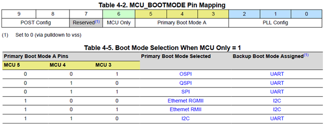

    As for the setting QSPI boot mode settings, however, makes sense to me (where SW9.2 is MCU4):
    SW8: 00000000
    SW9: 00100000
    In addition, if I was to set it to OSPI boot mode, will the switch setting be as shown below?
    SW8: 00000000
    SW9: 01000000
    Many Thanks,
    Philip
  • In addition, if I was to set it to OSPI boot mode, will the switch setting be as shown below?
    SW8: 00000000
    SW9: 01000000
    That is correct.
    SW8: 00000000
    SW9: 00100000
    Okay.
    Now getting to your SD boot mode. Let me clarify that. You must look at EVM user guide for the exact pin mapping: https://www.ti.com/lit/ug/spruis4d/spruis4d.pdf?ts=1651555074394&ref_url=https%253A%252F%252Fwww.google.com%252F
    Page: 21
    The SW8.1 pin maps to Primary Boot Mode B
    Now Looking at TRM:
    SW8.1 should be set to 1 i.e Primary Boot Mode B Pin should be 1.
    Also the Primary Boot Mode Config pins should be set to 001 as per below table in TRM:
    Primary Boot Mode Config Pins -->
    This is set to 001.
    To make it clear: Primary Boot Mode Config should be 001 & Primary Boot Mode A is 000.
