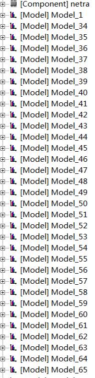

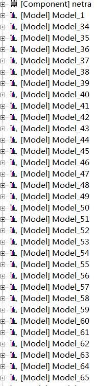

Eason,
Which model are they looking at? The models on the web include selectors for each pin. The selectors include different models for each pin corresponding to a specific configuration for that pin. It is necessary for the customer to know exactly how the pin is configured in order to be able to select the correct model from the selector for that use case.
The use case for the pin is under customer control so depends on their specific software.
They can examine the IBIS model 'datasheet' which is included in the downloadable ZIP file for more information on exactly how each model is configured.
