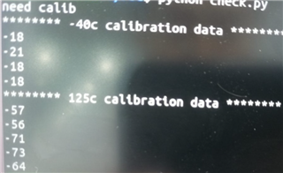

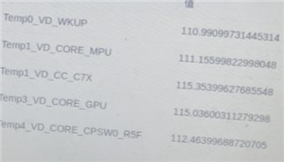

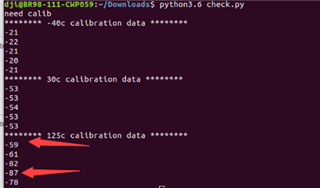

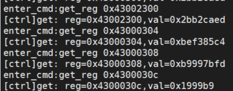

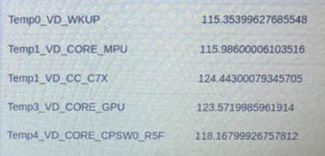

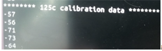

     on the  errorate i2128 It is described that the sensor sensor is calibrated at the factory, and the calibrated 5 temperature sensor data are written in VTM EFUSEx.
     in the  errorate i2128,VTM efuse story 5 temperature sensor calibrated  data,but on the sdk7.3;iThe calibration data of the first temperature sensor is used as the calibration data of 5 temperature sensors。
     my question is:
           1,Why not use the calibration data for each temperature sensor individually to correct?
           2,Is it because the bias of each sensor is consistent? Is this conclusion based on batch data from production? how mach is the calibration deviation of the 5 sensors?
   on the sdk7.3 patch csl_pvt_sensor_lut.h There are two lookup tables here:
          gCSL_pvt_poly_golden:Same as the function in the TDA4 TRM manual
          gCSL_pvt_poly:  I don't know where this table came from
         my question is:
           1,Why are there two tables and what do they mean?

    the picture 1: read tda4 five temp sensor by SDK 7.3
         VD_CD_C7X & VD_CORE_GPU is  About 9 degrees higher than other temperatures. Our C71 90% load; gpu 0% load; other cores are basically 70~90% load
    my question is:
       1. Why is the temperature difference of the 5 sensors inside the chip so big?
    The second picture reads the register data of VTM efuse:
    When the temperature is 125 degrees, the calibration data recorded internally, PVT2/PVT3 is about 13 higher than PVT0, and it can be seen from the table that there is a difference of about 2 °C
    my question is:
       1. There are two degrees of calibration difference, why is PVT0 still used as all?

    1,Here are 5 data representing the calibration values of the 5 temperature sensors in the VTM efuse
    2,From this data, if the 3rd and 4th temperature sensors are calibrated with their own calibration data, then in the case of 125 degrees, it will be two degrees lower than the calibration value of the 1st sensor.
    3,I read the calibration value of some other tda4, the difference is 4 ℃ in the case of 125 degrees
    my question is:
            why The hardware validation advised to use the first sensor table for all the sensors.

       When the temperature  is at 125 ℃, the five sensor’s value is different, the maximum difference is reach to 17℃, is it reasonable? When the temperature is at -40 or -30  ℃,  no so much different. Could you please advise customer how to use the calibration data?
       The external temperature is get by thermocouple. Thanks.

  • The highest temperature is near a very heavily loaded component. It is certainly reasonable that the highest temperature would be there. Have you tried lowering the work load on C7 in order to see if those high temperature differences change?
    Kevin

  • Linjun, Tang,
    Can you provide these register values for the unit being tested:
     WKUP_SPARE_FUSE0/1/2/3
    Also, can you summarize which cores in the system are being loaded and what is the loading configuration?  I understand it's using the thermal load software from Keerthy, right?
    Kyle
  • WKUP_SPARE_FUSE0/1/2/3
    A72=70,MCU=70,R5F=90,C6X=90,C71=90,GPU=0,LDC=90,MSC=90,SDE=90,VISS=50

    Look at the following two pictures, they are the same soc, one-to-one correspondence
    Other pictures should not be in one-to-one correspondence and can be ignored
    -40C coefficient is 0x2b (6-bit signed integer) is -21
    30c coefficient is 0xca (8-bit signed integer) is -54
    125c coefficient is 0x1ae (6-bit signed integer) is -82
    i read other。4C @ 125C
