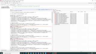

    while compiling "platform_test_evmc6657l" project, getting below error :
    **** Build of configuration Debug for project platform_test_evmc6657l ****
    "C:\\ti\\ccs930\\ccs\\utils\\bin\\gmake" -k all
    Building file: "../src/platform_test.c"
    Invoking: C6000 Compiler
    "C:/ti/ccs930/ccs/tools/compiler/ti-cgt-c6000_8.3.5/bin/cl6x" -mv6600 --abi=eabi -g --include_path="C:/ti/ccs930/ccs/tools/compiler/ti-cgt-c6000_8.3.5/include" --include_path="C:/ti/pdk_c665x_2_0_16/packages/ti/csl" --include_path="C:/ti/pdk_c665x_2_0_16/packages" --include_path="C:/ti/pdk_c665x_2_0_16/packages/ti/platform" --display_error_number --diag_warning=225 --preproc_with_compile --preproc_dependency="src/platform_test.d_raw" --obj_directory="src" "../src/platform_test.c"
    >> Compilation failure
    src/subdir_rules.mk:9: recipe for target 'src/platform_test.obj' failed
    "../src/platform_test.c", line 34: fatal error #1965: cannot open source file "cerrno"
    1 catastrophic error detected in the compilation of "../src/platform_test.c".
    Compilation terminated.
    gmake: *** [src/platform_test.obj] Error 1
    gmake: Target 'all' not remade because of errors.
    **** Build Finished ****

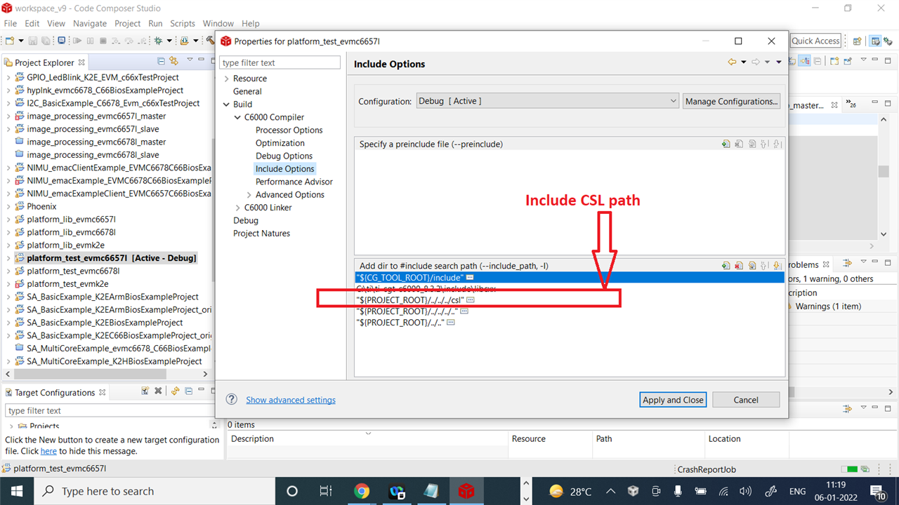

  • thanks for reply,
    While following fresh al steps mention as below :
    Step 2: Import the "Platform test example" into CCS 9.3 and re-build
    Please follow the video attached and do the steps given below for ease of use.
    a) Import the "Platform-Lib" CCS project located at "C:\ti\pdk_c665x_2_0_16\packages\ti\platform\evmc6657l\platform_lib" into CCS and rebuild

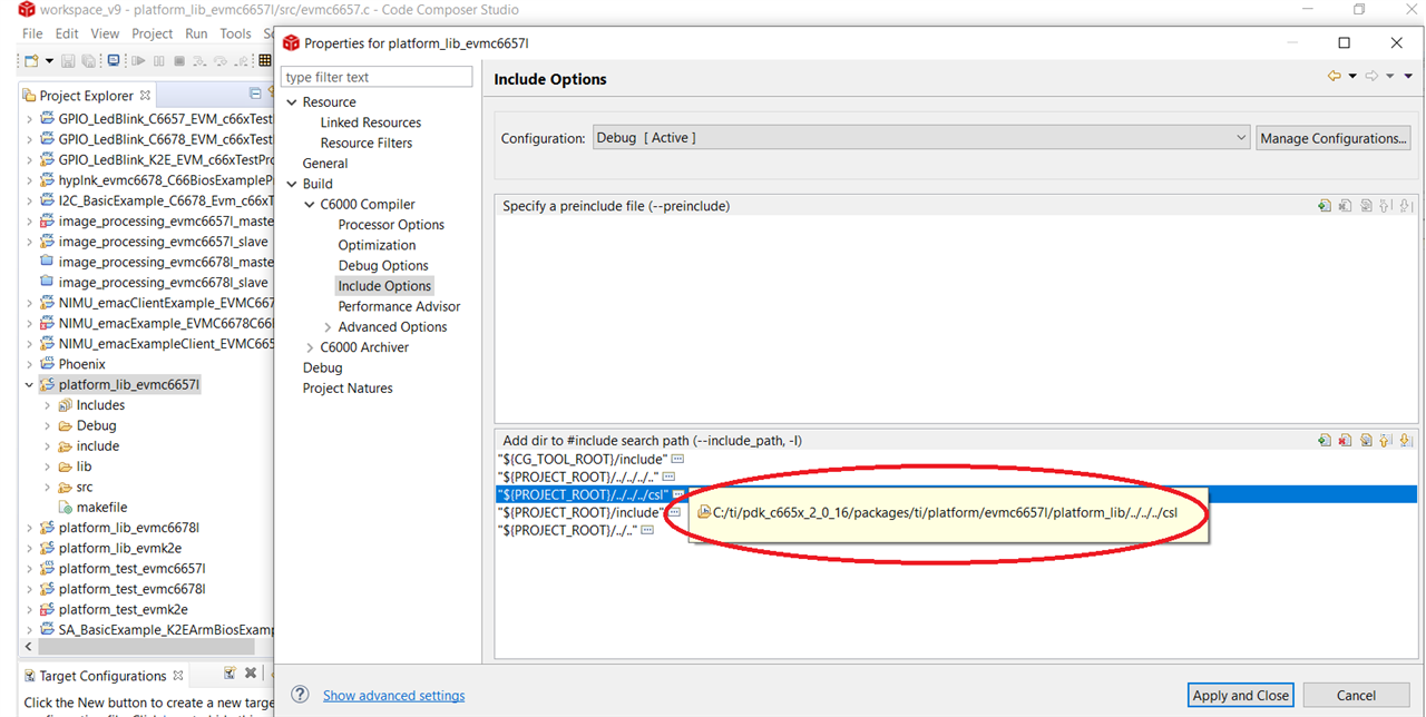

    we are getting below error 100
    **** Build of configuration Debug for project platform_lib_evmc6657l ****
    Building file: "../src/evm665x_i2c.c"
    "C:/ti/ccs930/ccs/tools/compiler/ti-cgt-c6000_8.3.5/bin/cl6x" -mv6600 --abi=eabi -g --include_path="C:/ti/ccs930/ccs/tools/compiler/ti-cgt-c6000_8.3.5/include" --include_path="C:/ti/pdk_c665x_2_0_16/packages" --include_path="C:/ti/pdk_c665x_2_0_16/packages/ti/csl" --include_path="D:/Workspace/platform_lib_evmc6657l/include" --include_path="C:/ti/pdk_c665x_2_0_16/packages/ti/platform" --display_error_number --diag_warning=225 --preproc_with_compile --preproc_dependency="src/evm665x_i2c.d_raw" --obj_directory="src" "../src/evm665x_i2c.c"
    >> Compilation failure
    src/subdir_rules.mk:9: recipe for target 'src/evm665x_i2c.obj' failed
    "C:/ti/pdk_c665x_2_0_16/packages/ti/csl/csl_semAux.h", line 89: error #20: identifier "CSL_SEMAPHORE_REGS" is undefined
    "C:/ti/pdk_c665x_2_0_16/packages/ti/csl/csl_semAux.h", line 130: error #20: identifier "CSL_SEMAPHORE_REGS" is undefined
    "C:/ti/pdk_c665x_2_0_16/packages/ti/csl/csl_semAux.h", line 168: error #20: identifier "CSL_SEMAPHORE_REGS" is undefined
    "C:/ti/pdk_c665x_2_0_16/packages/ti/csl/csl_semAux.h", line 209: error #20: identifier "CSL_SEMAPHORE_REGS" is undefined
    "C:/ti/pdk_c665x_2_0_16/packages/ti/csl/csl_semAux.h", line 252: error #20: identifier "CSL_SEMAPHORE_REGS" is undefined
    "C:/ti/pdk_c665x_2_0_16/packages/ti/csl/csl_semAux.h", line 293: error #20: identifier "CSL_SEMAPHORE_REGS" is undefined
    "C:/ti/pdk_c665x_2_0_16/packages/ti/csl/csl_semAux.h", line 335: error #20: identifier "CSL_SEMAPHORE_REGS" is undefined
    "C:/ti/pdk_c665x_2_0_16/packages/ti/csl/csl_semAux.h", line 384: error #20: identifier "CSL_SEMAPHORE_REGS" is undefined
    "C:/ti/pdk_c665x_2_0_16/packages/ti/csl/csl_semAux.h", line 425: error #20: identifier "CSL_SEMAPHORE_REGS" is undefined
    "C:/ti/pdk_c665x_2_0_16/packages/ti/csl/csl_semAux.h", line 469: error #20: identifier "CSL_SEMAPHORE_REGS" is undefined
    "C:/ti/pdk_c665x_2_0_16/packages/ti/csl/csl_semAux.h", line 517: error #20: identifier "CSL_SEMAPHORE_REGS" is undefined
    "C:/ti/pdk_c665x_2_0_16/packages/ti/csl/csl_semAux.h", line 568: error #20: identifier "CSL_SEMAPHORE_REGS" is undefined
    "C:/ti/pdk_c665x_2_0_16/packages/ti/csl/src/ip/psc/V0/csl_pscAux.h", line 86: error #20: identifier "CSL_PSC_REGS" is undefined
    "C:/ti/pdk_c665x_2_0_16/packages/ti/csl/src/ip/psc/V0/csl_pscAux.h", line 124: error #20: identifier "CSL_PSC_REGS" is undefined
    "C:/ti/pdk_c665x_2_0_16/packages/ti/csl/src/ip/psc/V0/csl_pscAux.h", line 167: error #20: identifier "CSL_PSC_REGS" is undefined
    "C:/ti/pdk_c665x_2_0_16/packages/ti/csl/src/ip/psc/V0/csl_pscAux.h", line 210: error #20: identifier "CSL_PSC_REGS" is undefined
    "C:/ti/pdk_c665x_2_0_16/packages/ti/csl/src/ip/psc/V0/csl_pscAux.h", line 250: error #20: identifier "CSL_PSC_REGS" is undefined
    "C:/ti/pdk_c665x_2_0_16/packages/ti/csl/src/ip/psc/V0/csl_pscAux.h", line 292: error #20: identifier "CSL_PSC_REGS" is undefined
    "C:/ti/pdk_c665x_2_0_16/packages/ti/csl/src/ip/psc/V0/csl_pscAux.h", line 331: error #20: identifier "CSL_PSC_REGS" is undefined
    "C:/ti/pdk_c665x_2_0_16/packages/ti/csl/src/ip/psc/V0/csl_pscAux.h", line 372: error #20: identifier "CSL_PSC_REGS" is undefined
    "C:/ti/pdk_c665x_2_0_16/packages/ti/csl/src/ip/psc/V0/csl_pscAux.h", line 416: error #20: identifier "CSL_PSC_REGS" is undefined
    "C:/ti/pdk_c665x_2_0_16/packages/ti/csl/src/ip/psc/V0/csl_pscAux.h", line 459: error #20: identifier "CSL_PSC_REGS" is undefined
    "C:/ti/pdk_c665x_2_0_16/packages/ti/csl/src/ip/psc/V0/csl_pscAux.h", line 502: error #20: identifier "CSL_PSC_REGS" is undefined
    "C:/ti/pdk_c665x_2_0_16/packages/ti/csl/src/ip/psc/V0/csl_pscAux.h", line 545: error #20: identifier "CSL_PSC_REGS" is undefined
    "C:/ti/pdk_c665x_2_0_16/packages/ti/csl/src/ip/psc/V0/csl_pscAux.h", line 588: error #20: identifier "CSL_PSC_REGS" is undefined
    "C:/ti/pdk_c665x_2_0_16/packages/ti/csl/src/ip/psc/V0/csl_pscAux.h", line 631: error #20: identifier "CSL_PSC_REGS" is undefined
    "C:/ti/pdk_c665x_2_0_16/packages/ti/csl/src/ip/psc/V0/csl_pscAux.h", line 679: error #20: identifier "CSL_PSC_REGS" is undefined
    "C:/ti/pdk_c665x_2_0_16/packages/ti/csl/src/ip/psc/V0/csl_pscAux.h", line 718: error #20: identifier "CSL_PSC_REGS" is undefined
    "C:/ti/pdk_c665x_2_0_16/packages/ti/csl/src/ip/psc/V0/csl_pscAux.h", line 759: error #20: identifier "CSL_PSC_REGS" is undefined
    "C:/ti/pdk_c665x_2_0_16/packages/ti/csl/src/ip/psc/V0/csl_pscAux.h", line 809: error #20: identifier "CSL_PSC_REGS" is undefined
    "C:/ti/pdk_c665x_2_0_16/packages/ti/csl/src/ip/psc/V0/csl_pscAux.h", line 860: error #20: identifier "CSL_PSC_REGS" is undefined
    "C:/ti/pdk_c665x_2_0_16/packages/ti/csl/src/ip/psc/V0/csl_pscAux.h", line 917: error #20: identifier "CSL_PSC_REGS" is undefined
    "C:/ti/pdk_c665x_2_0_16/packages/ti/csl/csl_xmcAux.h", line 115: error #20: identifier "CSL_DSP_DSP_XMC_CTRL_REGS" is undefined
    "C:/ti/pdk_c665x_2_0_16/packages/ti/csl/csl_xmcAux.h", line 194: error #20: identifier "CSL_DSP_DSP_XMC_CTRL_REGS" is undefined
    "C:/ti/pdk_c665x_2_0_16/packages/ti/csl/csl_xmcAux.h", line 247: error #20: identifier "CSL_DSP_DSP_XMC_CTRL_REGS" is undefined
    "C:/ti/pdk_c665x_2_0_16/packages/ti/csl/csl_xmcAux.h", line 308: error #20: identifier "CSL_DSP_DSP_XMC_CTRL_REGS" is undefined
    "C:/ti/pdk_c665x_2_0_16/packages/ti/csl/csl_xmcAux.h", line 352: error #20: identifier "CSL_DSP_DSP_XMC_CTRL_REGS" is undefined
    "C:/ti/pdk_c665x_2_0_16/packages/ti/csl/csl_xmcAux.h", line 396: error #20: identifier "CSL_DSP_DSP_XMC_CTRL_REGS" is undefined
    "C:/ti/pdk_c665x_2_0_16/packages/ti/csl/csl_xmcAux.h", line 440: error #20: identifier "CSL_DSP_DSP_XMC_CTRL_REGS" is undefined
    "C:/ti/pdk_c665x_2_0_16/packages/ti/csl/csl_xmcAux.h", line 490: error #20: identifier "CSL_DSP_DSP_XMC_CTRL_REGS" is undefined
    "C:/ti/pdk_c665x_2_0_16/packages/ti/csl/csl_xmcAux.h", line 531: error #20: identifier "CSL_DSP_DSP_XMC_CTRL_REGS" is undefined
    "C:/ti/pdk_c665x_2_0_16/packages/ti/csl/csl_xmcAux.h", line 576: error #20: identifier "CSL_DSP_DSP_XMC_CTRL_REGS" is undefined
    "C:/ti/pdk_c665x_2_0_16/packages/ti/csl/csl_xmcAux.h", line 620: error #20: identifier "CSL_DSP_DSP_XMC_CTRL_REGS" is undefined
    "C:/ti/pdk_c665x_2_0_16/packages/ti/csl/csl_xmcAux.h", line 685: error #20: identifier "CSL_DSP_DSP_XMC_CTRL_REGS" is undefined
    "C:/ti/pdk_c665x_2_0_16/packages/ti/csl/csl_xmcAux.h", line 729: error #20: identifier "CSL_DSP_DSP_XMC_CTRL_REGS" is undefined
    "C:/ti/pdk_c665x_2_0_16/packages/ti/csl/csl_xmcAux.h", line 766: error #20: identifier "CSL_DSP_DSP_XMC_CTRL_REGS" is undefined
    "C:/ti/pdk_c665x_2_0_16/packages/ti/csl/csl_xmcAux.h", line 804: error #20: identifier "CSL_DSP_DSP_XMC_CTRL_REGS" is undefined
    "C:/ti/pdk_c665x_2_0_16/packages/ti/csl/csl_xmcAux.h", line 841: error #20: identifier "CSL_DSP_DSP_XMC_CTRL_REGS" is undefined
    "C:/ti/pdk_c665x_2_0_16/packages/ti/csl/csl_xmcAux.h", line 879: error #20: identifier "CSL_DSP_DSP_XMC_CTRL_REGS" is undefined
    "C:/ti/pdk_c665x_2_0_16/packages/ti/csl/csl_xmcAux.h", line 935: error #20: identifier "CSL_DSP_DSP_XMC_CTRL_REGS" is undefined
    "C:/ti/pdk_c665x_2_0_16/packages/ti/csl/csl_xmcAux.h", line 983: error #20: identifier "CSL_DSP_DSP_XMC_CTRL_REGS" is undefined
    "C:/ti/pdk_c665x_2_0_16/packages/ti/csl/csl_xmcAux.h", line 1019: error #20: identifier "CSL_DSP_DSP_XMC_CTRL_REGS" is undefined
    "../src/evm665x_i2c.c", line 60: error #20: identifier "CSL_I2C_DATA_CONTROL_REGS" is undefined
    53 errors detected in the compilation of "../src/evm665x_i2c.c".
    gmake: *** [src/evm665x_i2c.obj] Error 1
    "../src/platform.c", line 214: warning #225-D: function "CSL_BootCfgIsLittleEndian" declared implicitly
    "../src/platform.c", line 492: warning #225-D: function "CSL_BootCfgGetMacIdentifier" declared implicitly
    "../src/platform.c", line 518: warning #225-D: function "CSL_BootCfgGetMacIdentifier" declared implicitly
    "../src/platform.c", line 544: error #20: identifier "CSL_GEM_MACRXINTN" is undefined
    53 errors detected in the compilation of "../src/platform.c".
    gmake: *** [src/platform.obj] Error 1
    thanks,
    sarita pandey
    We compile "platform_lib_evmc6657l" and include CSL in project option then below error are coming, please see the attached screenshot.
  • Sarita,
    There seems to be some mismatch in the steps you followed.
    May I recommend, you to uninstall and re-install everything.
    Shankari G

  • Sarita,
    Please refer to the videos and snapshot on how to add the CSL path in the project-build configuration.
    Shankari G

  • Customer,
    This query is taken care internally and resolved completely through anydesk and webex.
    Observation:
    If the steps are followed correctly given in the user guide below, CCS errors will be resolved.
    And additionally, these steps likely to be added in the user guide too.
    CCS Error - Cause
    1. on platform test
      1. - the SOC_C6657 should be defined in the predefined symbols
      2. the cgt should be included in the project build path - C:\ti\ti-cgt-c6000_8.3.2\include\libcxx
    2. On the platform lib
      1. the SOC_C6657 should be defined in the predefined symbols
    https://e2e.ti.com/support/processors-group/processors/f/processors-forum/1101435/processor-sdk-k2h-we-are-building-processor-sdk-linux-for-k2hk-evm
