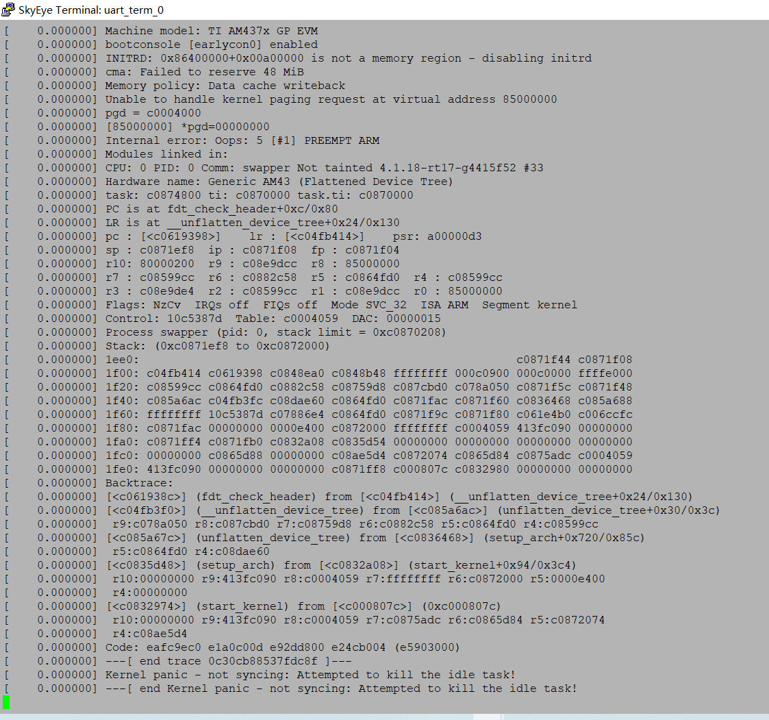

The following errors occurred when porting linux-rt-4.1 to am437x EVM startup
1. Unable to handle kernel paging request at virtual address 85000000
2. Initrd: 0x86400000 + 0x00a00000 is not a memory region - disabling initrd 86400000 is my root file system load address 0x00a00000 is size
