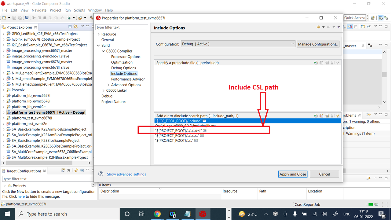

I am using Eval board(TMS320C6657), when I compile example source code (C:\ti\pdk_c665x_2_0_16\packages\ti\platform\evmc6657l\platform_lib and test) getting error, I also include CSL library package file, Please check below attachment.
Code Composer version:- CCSTUDIO_9.3.0.00012
Software  Development Kit:- \PROCESSOR-SDK-RTOS-C665x  06_03_00_106
project is in critical situation, we have 3 system getting same issue, so if possible please take my pc remotely and resolve these error.

    Please follow the steps given here. https://e2e.ti.com/support/processors-group/processors/f/processors-forum/1071275/faq-tms320c6657-how-to-build-and-run-the-platform-test-on-c6657-evm
    If you are unable to solve, let me take remote PC and solve.
    Post the screenshot where you added the CSL path. In the screenshots you provided, it does not have the screenshot of "project configuration".

    Meanwhile, try this video and snapshot on how to add the path of CSL.

  • Customer,
    This query is taken care internally and resolved completely through anydesk and webex.
    Observation:
    If the steps are followed correctly given in the user guide below, CCS errors will be resolved.
    And additionally, these steps likely to be added in the user guide too.
    CCS Error - Cause
    1. on platform test
      1. - the SOC_C6657 should be defined in the predefined symbols
      2. the cgt should be included in the project build path - C:\ti\ti-cgt-c6000_8.3.2\include\libcxx
    2. On the platform lib
      1. the SOC_C6657 should be defined in the predefined symbols
