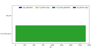

TDA4VM: FPS of resnet50 on TIDL too low
Part Number: TDA4VM
Problem: FPS of resnet50 on TIDL too low
Environment used:
Edgeai-tidl-tools and torchvision-ti
The above git repos were installed in separate docker environments.
Reproduction steps:
1) We have used torchvision-ti environment to generate the onnx format. We got the resnet model using the following line of code
resnet_model = xvision.models.__dict__['resnet50_x1'](model_config)
This was used to convert to onnx format.
2) We used code from edgeai-tidl-tools/examples/jupyter_notebooks/custom-model-onnx.ipynb to convert the model from onnx to TIDL.
Noticing the fps stats from that code, it shows that the resnet50 takes around 0.5 fps.
I believe that this needs to be higher. Could you let me know if there are any steps I am missing? Maybe there are specific steps or version that I need to use?
Thank You
Niranjan
  • Hi Niranjan,
    Can you please share the generated model? I am suspecting some nodes may be getting delegated to ARM instead of C7x-MMA which could be a possible cause of the lower fps.
    Anand
  • Hi Anand,
    I am attaching the onnx model here.(link)
    I have seen the output logs and they are as follows. It shows that all the layers are TIDL supported

    The Inference was as follows -
    Inferences Per Second : 0.52 fps
    Inference Time Per Image : 1906.41 ms
    DDR BW Per Image : 0.00 MB
    Also, the graph shows that there were no CPU executions.
    I am not sure what is missing exactly?

  • Hi Niranjan,
    Are you getting 0.5 fps even with debug_leve = 0? Just checking since setting debug_level > 0 results in higher inference times than expected.
    Anand
  • Hi Anand,
    I tried the option of debug_level=0 and it didn't really change much.
    We did feel that the simulation could be an issue so we did try it on the tda4vm hardware. We were able to get an FPS of around 13 for resnet50 with the resolution of 224*224.
    However, I do see the benchmark is higher => around 40 fps.
    Second question -> does the benchmar stats of TI, from the repo https://github.com/TexasInstruments/edgeai-tidl-tools, does not always represent the hardware?
    Thank You
    Niranjan
  • Hi Niranjan,
    Second question -> does the benchmark stats of TI, from the repo https://github.com/TexasInstruments/edgeai-tidl-tools, does not always represent the hardware?
    => No, it does not always represent the hardware, if you run on PC, it will give corresponding benchmarking value for PC and for hardware it will give the hardware value. So 0.5 fps was PC execution time.
    Regarding the benchmark of 40 fps, can you please specify from where you are quoting this benchmark?
    Anand
  • Hi Niranjan,
    I tried running the above attached 299*299 resolution model on my end and I am getting around 120 fps for the same.
    Inferences Per Second : 121.06 fps
    Inference Time Per Image : 8.26 ms
    Anand
  • Hi Anand,
    I see that the TIDL graph execution is around 8.616 ms.
    However, including time from other operations like file io and draw operations, it comes around 32 ms(31 fps).
    This is currently enough for our use case. I believe the main issue was with the simulator.
    Thank You
    Niranjan
