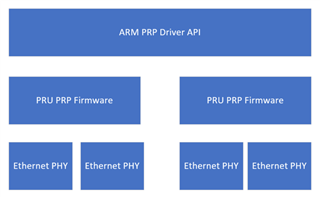

We are investigating using PRP with the PRU cores on our am571x based board.
Would an implementation like this be possible with the PRU-ICSS-HSR-PRP-DAN_01.00.05.01 code?
So our idea is to have two separate PRP network, PRP network A and PRP network B, where network A has two ethernet ports (with one MAC Address), and network B has two other ethernet ports (with one Mac address). In total 4 ethernet ports.
Is this a usual way of configuring PRP, and do you think it is a possible to go?
